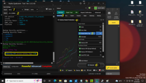

Share kolang mga boss Vivo y11 frp remove by hydra Tool
PROCEDURE
Pa detect muna si unit using TESTPOINT
kapag na detect na sa device manager
Open hydra Qualcomm Module
1 Select Brand Vivo
2 Select Model y11 (1906)
3 Click Universal Tab
4 Select Factory Reset Protection
5 Click Erase Safety Tag
6 Execute
FRP REMOVE DONE
