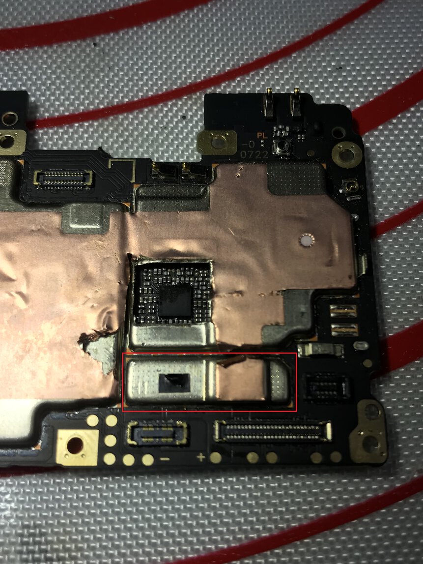

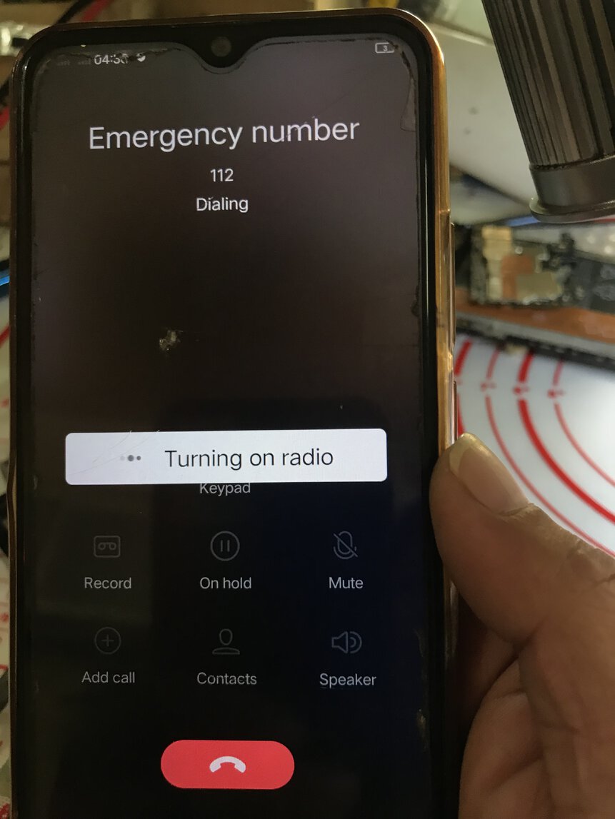

History bigla na lang nawala signal at no service..
once mag dial ka emergency call number na 112 Turning on Radio lumalabas..
syempre as usual WTR ang salarin kaya replace..
pero no luck no service pa rin :D :D :D
pero may solutiion ako jan..
ilang beses ko na ito nagawa oras na para ilabas dahil kunti lang kayo nag AF :D:D:D

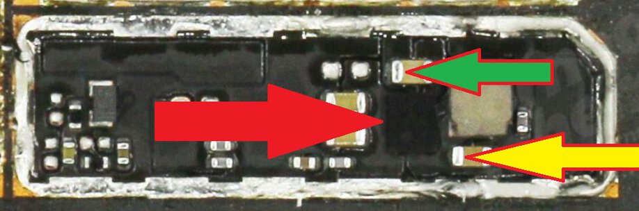

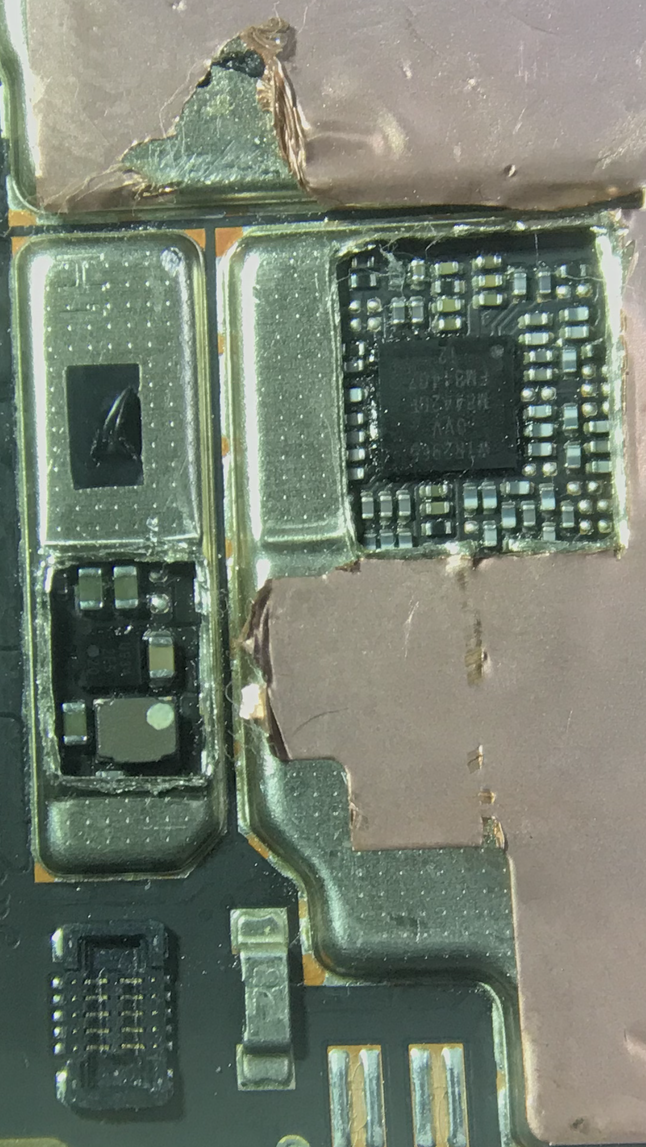

first open this shield
ganito mkikita nyo
RED arrow QET4101 signal ic supply of VPA APT (same function sa poco M3 unli reboot solution)
green arrow input 3.7v vphpwr or vsys
yellow arrow output to 2g Pa and 3g Pa
wala akong pinalitan reballs ko lang ung ic na yan..
kailangan may output voltage dito 1.8v to 3.0v with sim card inserted..
pag wala palitan nyo na.. (a3s a5s Etc meron niyan) :D

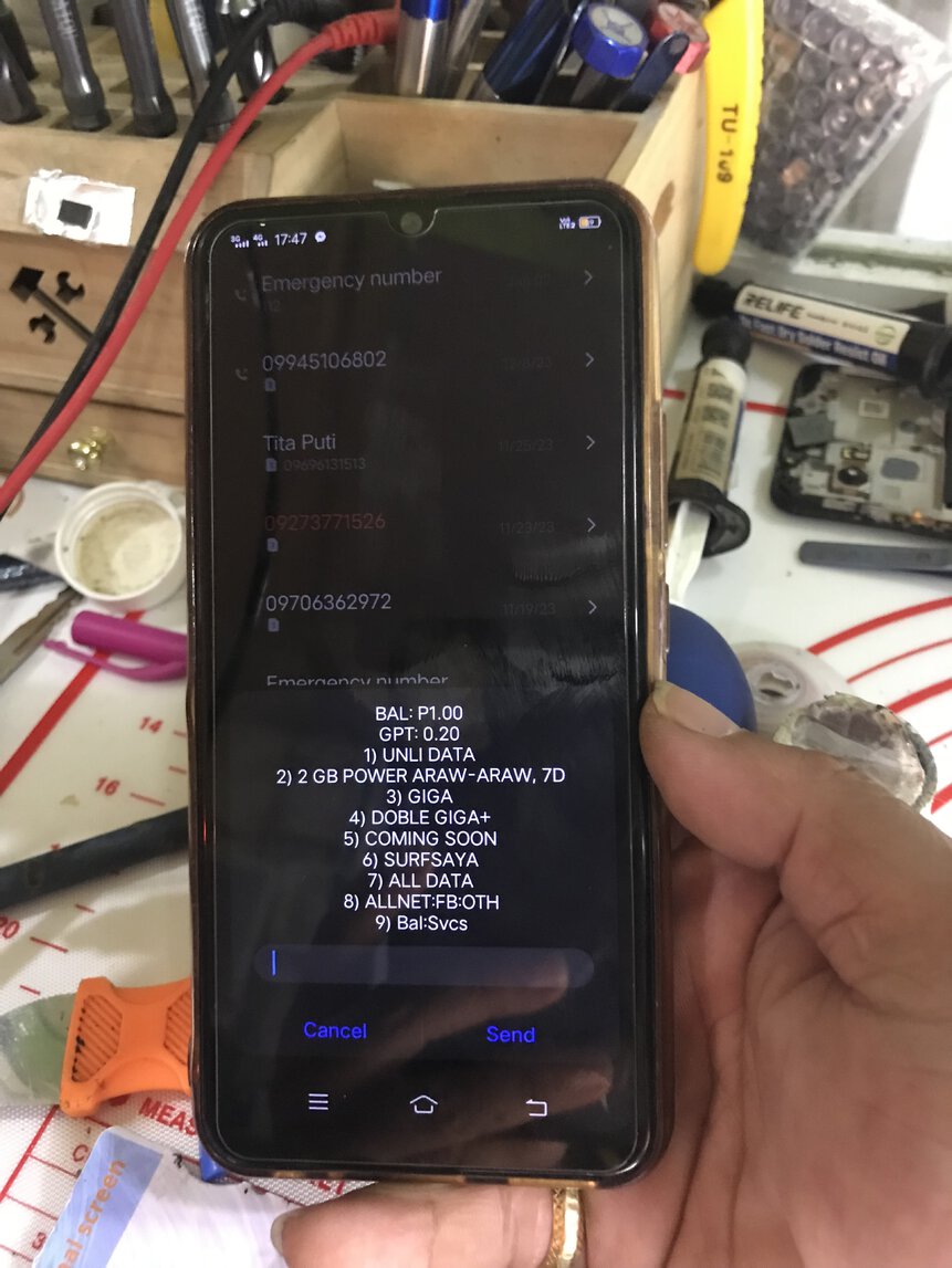

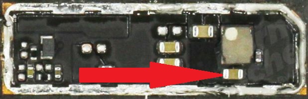

after reball done..
haba ng paliwanag pero lahat ng post ko pinag aralan at walang tsamba..
sana makatulong..!!!
