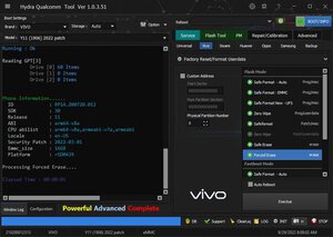

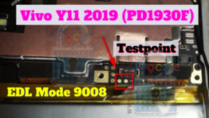

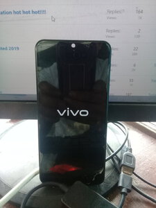

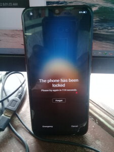

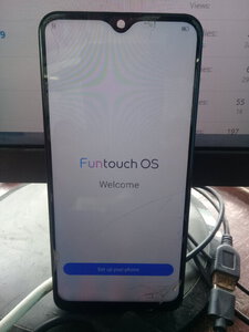

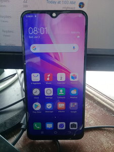

PROCEDURE:
Open Hydra Qualcomm
Select Brand: Vivo
Select Model: Y11 2022 patch
Click Vivo Tab
factory reset/format user data
tick force erase
then execute..
need tp mga boss....
