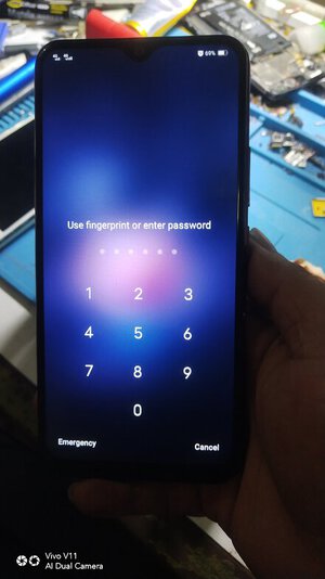

Password problem

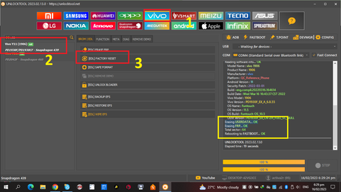

* remove battery
* open unlocktool
* vivo tab
* select Y11 for model

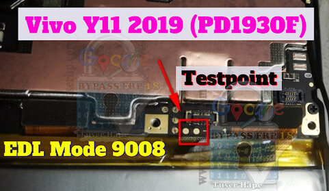

* connect Testpoint to Ground (see image) and insert usb
* under BROM/ EDL tab click (EDL Factory Reset)

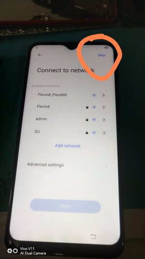

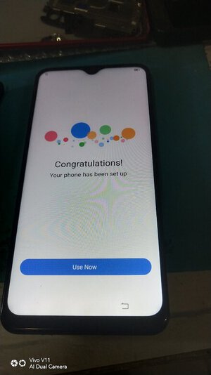

may skip na....

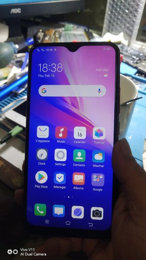

Done!!!
