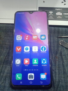

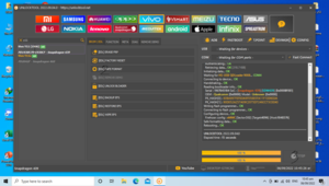

tsunami Registered Joined Jan 5, 2015 Messages 244 Reaction score 42 Points 1 Location Surigao City, Surigao del norte Sep 8, 2022 #1 vivo 1906 password done kay Unlock Tool -ito sya naka password pa -open unlock tool -click vivo -search 1906 -click safe (EDL) safe format dahil gusto ni tumer walang mabura -automatic na yan open menu no need na tanggal frp done.. finish product.....

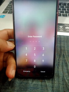

kier2022 Registered Joined Feb 8, 2022 Messages 107 Reaction score 39 Points 51 Location davao Oct 6, 2022 #2 via test point ba master?
kier2022 Registered Joined Feb 8, 2022 Messages 107 Reaction score 39 Points 51 Location davao Oct 7, 2022 #3 sinubukan ko kaso may password padin
EJSCriminal Registered Joined May 9, 2019 Messages 83 Reaction score 71 Points 1 Location Tagum City Oct 24, 2022 #4 kier2022 said: sinubukan ko kaso may password padin Click to expand... Kapag ganyan po mataas na ang security patch
tsunami Registered Joined Jan 5, 2015 Messages 244 Reaction score 42 Points 1 Location Surigao City, Surigao del norte Oct 24, 2022 #5 kier2022 said: via test point ba master? Click to expand... no need na boss direct lagay lang ng usb cable ok na
