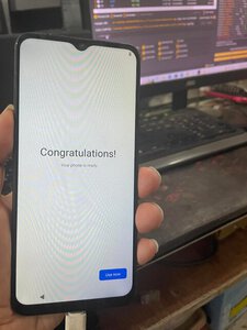

issue dala ni tumer
na update daw tapos namatay nalang
try ko saksak sa pc. ayun deadboot.
hanap firmware agad.

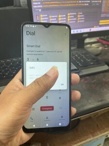

meron ako nakita pag flash success pero naging 16gb nalang yung storage
nagreklamo si tumer dahil 32gb daw phone niya bakit naging 16gb nalang.
hanap ulit. ito na solution download niyo fimrware nato
https://www.mediafire.com/file/ybl80p872hsvx4q/Vivo_Y12S_PD2036F_MT6765_EX_A_1.72.10_190321.zip/file
note pag error flashing sa prealoder, sali niyo rin preloader niya para di mag error( pag deadboot parin)
step 1 after download extract lang
step 2 open tools unlocktool gamit ko. procced agad sa mediatek universal tab.
step 3 select scatter file agad kay firmware mula kay unloctool
step 4 flash
step 5 wait hanggang matapos
step 6 done.
