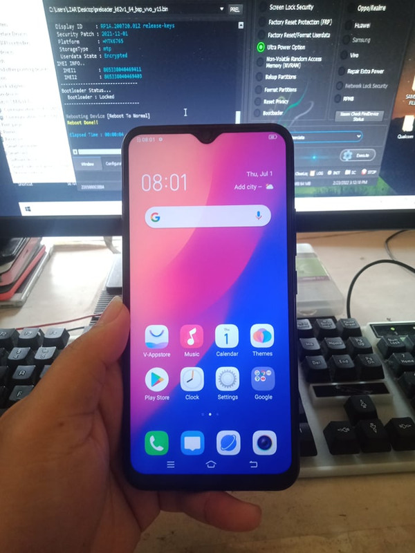

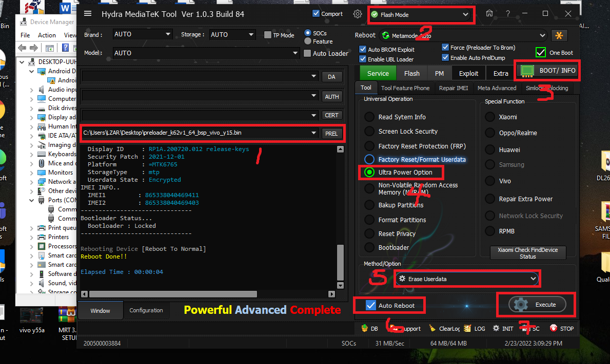

unit: Vivo y15 1909 password problem
uncheck auto loader
browse -preloader_k62v1_64_bsp_vivo_y15.bin
select -flashmode
select -boot info
insert usb cable to pc
wait nyo lang po maread......
select -ultra power option
select -erase userdata
check auto reboot
then EXECUTE!!

Preparing Download Agent..
DA : [Not Exist]
Trying Default 6765_PL.bin
Agent: MTK_DOWNLOAD_AGENT -HYDRA
Ver : MTK_AllInOne_DA_v3.3001.2020-11-03.21:13_536568
Init : Loader [1]
Sending : Accepted
Identifying Protocol...
ERROR : CMD_JUMP_DA
Elapsed Time : 00:00:12
Ang hirap intindihin sa Pag remove ng Pass dol hehehe parang flashing style ahh
