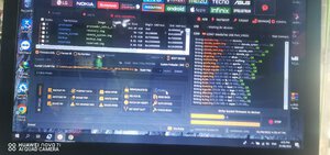

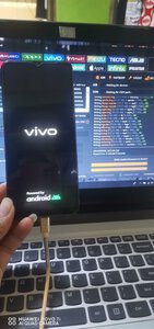

dinala sakin ni co tech inalis nya raw password ayun tinupak namatay.. pero chineck ko detected pa
ACTION TAKEN:
Hanap kay pareng google scatter file
link here: https://mega.nz/file/4oFkGDoK#RAW1WFS...
password: soft4gsm.pk
Open natin si mahiwagang UNLOCKTOOL
Click mediatek tab - MTK UNIVERSAL
Load scatter file na dl mu
TICK FLASH
No boot key salpak na agad wait until done
sa una parang restart logo ok lang wait mu lang
sana makatulong po
