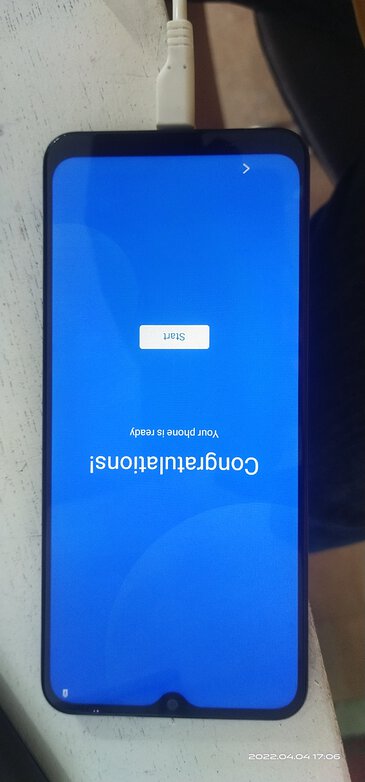

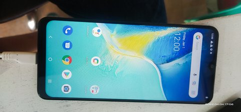

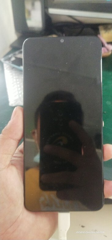

VIVO Y15S 100% TESTED FLASH FILE FOR DEADBOOT UNIT
click beside logo to download

salamat paps sa tested file mo,,,

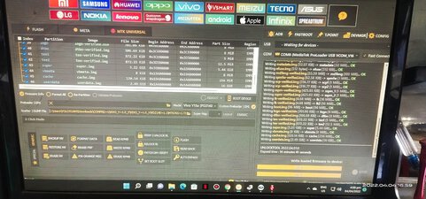

FLASH Authenticating... OK
Initializing usb... OK
Waiting for device... COM5
Bypassing authentication... OK
Analyzing preloader... preloader_k65v1_32_bsp_2g_ago.bin [EMI:9] [Custom]
Handshaking... OK
Reading hardware info... OK
Hardware : MT6765 [Helio G25|G35|P35] 0766 8A00 CA00 0000
Security Config : SCB SLA DAA
MEID : 0402ADFB1E52348A082A2195EF3F3B08
Sending Download-Agent... OK
Syncing with target... OK
Booting device... OK
Syncing with DA... OK
Storage : EMMC - CID : 474E0113.52394A31.C151038.4588787D
Vendor : Micron - Name : G1J9R8 - Serial : 2021461013 - Rev : 16
Boot1 : 4 MiB - Boot2 : 4 MiB - RPMB : 16 MiB - User Area : 58.24 GiB
Tips : GPT not initialized! Using scatter as partition map!
Writing preloader_k65v1_32_bsp_2g_ago.bin [243.89 KiB] -> preloader [256 KiB]... OK
Writing preloader_k65v1_32_bsp_2g_ago.bin [243.89 KiB] -> preloader_backup [256 KiB]... OK
Writing recovery.img [96 MiB] -> recovery [96 MiB]... OK
Writing vbmeta_system.img [4 KiB] -> vbmeta_system [8 MiB]... OK
Writing vbmeta_vendor.img [4 KiB] -> vbmeta_vendor [8 MiB]... OK
Writing factory.img [80 MiB] -> factory [80 MiB]... OK
Writing vbmeta_oem.img [8 KiB] -> vbmeta_oem [64 KiB]... OK
Writing vbmeta_vgc.img [4 KiB] -> vbmeta_vgc [64 KiB]... OK
Writing metadata.img [52.07 KiB] -> metadata [32 MiB]... OK
Writing efuse.img [512 bytes] -> efuse [512 KiB]... OK
Writing md1img-verified.img [55.59 MiB] -> md1img [100 MiB]... OK
Writing spmfw-verified.img [62.58 KiB] -> spmfw [1 MiB]... OK
Writing scp-verified.img [316.77 KiB] -> scp1 [1 MiB]... OK
Writing scp-verified.img [316.77 KiB] -> scp2 [1 MiB]... OK
Writing sspm-verified.img [425.03 KiB] -> sspm_1 [1 MiB]... OK
Writing sspm-verified.img [425.03 KiB] -> sspm_2 [1 MiB]... OK
Writing lk-verified.img [4.68 MiB] -> lk [16 MiB]... OK
Writing lk-verified.img [4.68 MiB] -> lk2 [16 MiB]... OK
Writing boot.img [96 MiB] -> boot [96 MiB]... OK
Writing logo-verified.bin [701.06 KiB] -> logo [8 MiB]... OK
Writing dtbo-verified.img [106.69 KiB] -> dtbo [8 MiB]... OK
Writing tee-verified.img [872.22 KiB] -> tee1 [5 MiB]... OK
Writing tee-verified.img [872.22 KiB] -> tee2 [12.5 MiB]... OK
Writing super.img [3.22 GiB] -> super [5.44 GiB]... OK
Writing vbmeta.img [8 KiB] -> vbmeta [8 MiB]... OK
Writing cache.img [120.14 KiB] -> cache [256 MiB]... OK
Writing userdata.img [2.49 GiB] -> userdata [16 GiB]... OK
UNLOCKTOOL 2022.04.11.0
Elapsed time : 5 minutes 4 seconds
FRP
[BROM] ERASE FRP Authenticating... OK
Waiting for device... COM33
Jumping to BROM... OK
Analyzing preloader... preloader_k65v1_32_bsp_2g_ago.bin [EMI:9] [Internal]
Handshaking... OK
Reading partition info... OK [47]
Reading device info... OK
Model Name : V2120
Product Name : 2020_TR
Manufacturer : vivo
Platform : k65v1_32_bsp_2g_ago
Android Version : 11
Security Patch : 2021-12-01
Display ID : RP1A.200720.012 release-keys
Build : eng.compil.20211209.143823
Build Date : Thu Dec 9 14:37:04 CST 2021
Vivo Model : 2020C
Vivo Version : PD2140F_EX_A_3.12.0
OS Name : vos
OS Version : 2.1
OS Build : Funtouch OS 11.1 Global
OEM Version : PD2140F_EX_CN-ZH_FULL_SC_NULL
Erasing FRP... OK
Elapsed time : 34 seconds​
