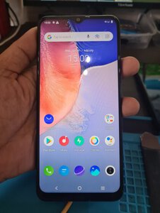

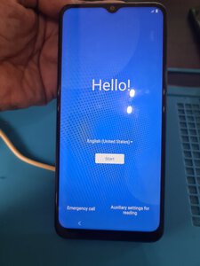

Vivo Y15S V2120
Problem
Password and FRP

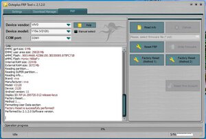

Password
Open Octoplus
Select Vivo Y15s
Hit Factory Reset Method 1
Turn off Phone
Connect phone to computer (Boot key Volume +)
wait till Finish

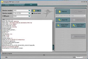

FRP
Open Octoplus
Select Vivo Y15s
Hit Reset FRP
Turn off Phone
wait till Finish
