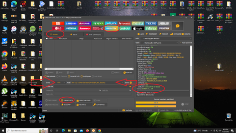

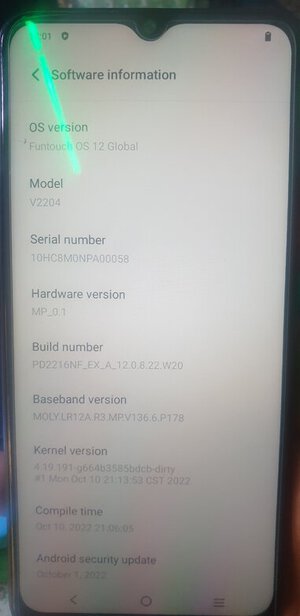

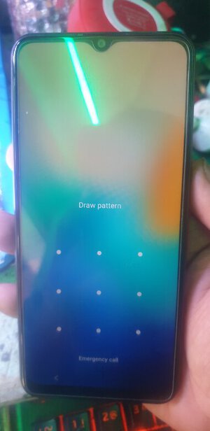

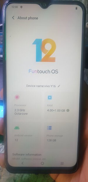

Share ko lang mga boss Vivo y16 (V2204) password problem
1.Open UnlockTool
2.Select: MEDIATEK
3.Select: FLASH
4.Check: Server.
5.Select:Brand VIVO --Select: Model Vivo Y12, New Sec Patch [PD190 1BF]_New_Security
6.Click:FORMAT
7.No boot key: Connect usb cable and wait until it done

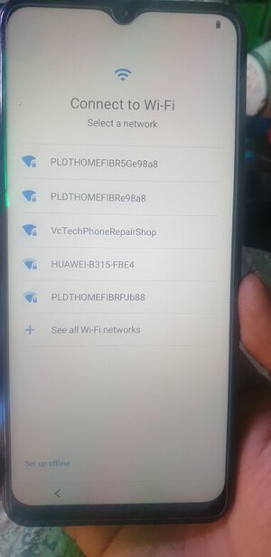

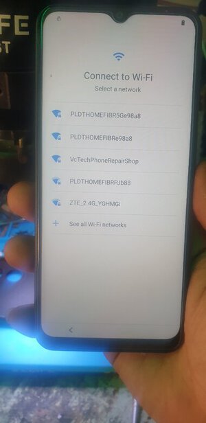

For FRP
Click: ERASE FRP, Power off your phone and connect Usb Cable then wait it done
ito po proof ko

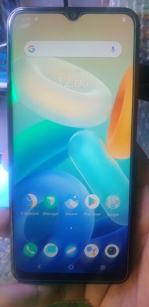

maraming salamat po nawa'y makatulong
