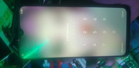

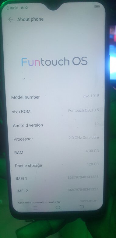

share ko lang po mga boss itong tanggap ko vivo y19 password problem
now try ko siya unlock sa Unlocktool pero jumping to brom lang at kusa nag open unit
na try ko narin search ibang model pero bigo, nagtaka lang ako kasi dati nMn nkakapag unlock na ako gamit unlocktool pero ok nMn
kaso itong huli ayaw na, akala ko may problema drivers,kaya install uleh drivers pero no luck,

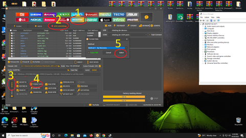

kaya nag search ako at may nakita ako solution with testpoint nga lang. at try ko at hindi nMn nabigo.
Process na tayo
1.Open: UnlockTool
2.Select: brand MEDIATEK
3.Select: MTK UNIVERSAL
4.Check: Custom Preloader | EMI
5.Click: BOOT DEVICE
6.Testpoint unit and Connect usb cable
antayin lang matapos
take note: wag tanggalin dahil hindi pa tapos

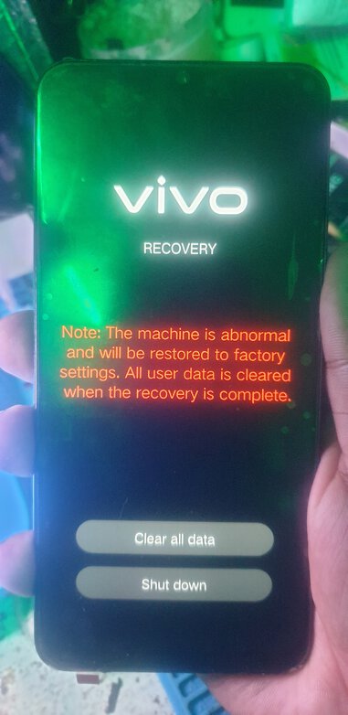

7.Select: FORMAT DATA
8.Select: Method 1- By RECOVERY and select
and wait it done

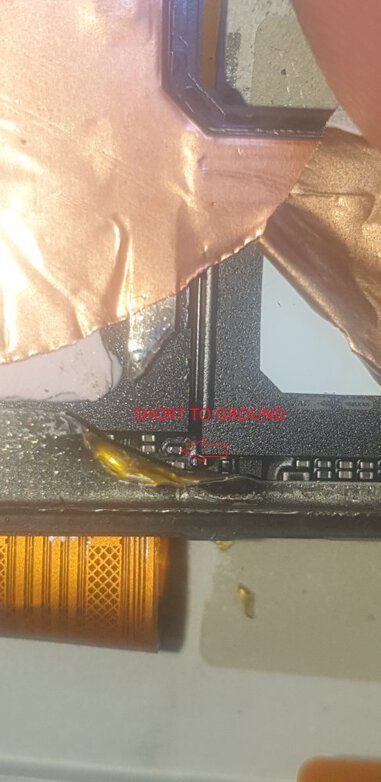

ito po TP.
vies ss nalang po
maraming salamat po
