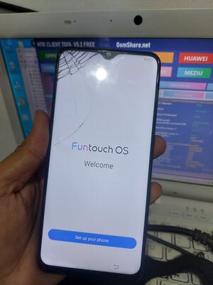

VIVO Y19 PASSWORD AND FRP USING MTK CLIENT TOOL WITH TP
PARA PO SA MAKUKUNAT AT JUMP BROOM
PASUNDAN NLANG PO

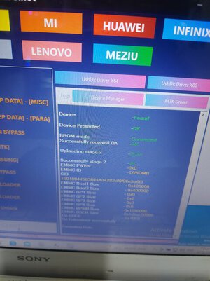

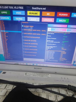

OPEN MTK CLIENT TOOL V5.2
CLICK VIVO
SELECT Y19
SELECT FACTORY RESET

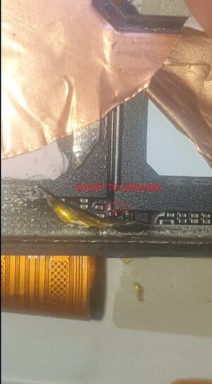

TESPOINT PO NSA PIC NA REMOVE BATTERY PO
THEN DONE
