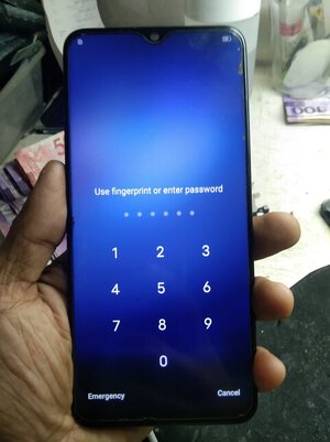

Blessed pm mga bos amo idol
Share ko lang to vivo y19 latest sp
Jumping broom error
Sana mkatulong po
History password lock
Solution

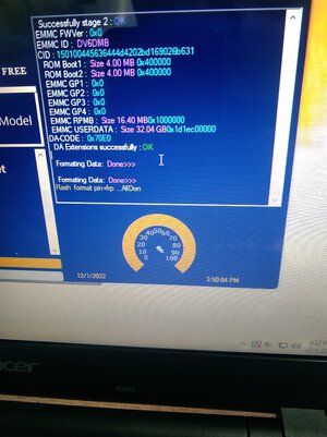

1open Aklan PinoyTech tool
2select BMB mtk tool v21
3vivo select y19
4select. Facttory
5tp unit saksak usb wait until done

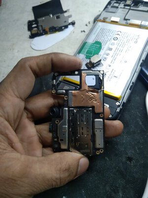

Sana. Mkatulong sa inyo take note ingat sa pag bklas ng cover sa gaagawing tp

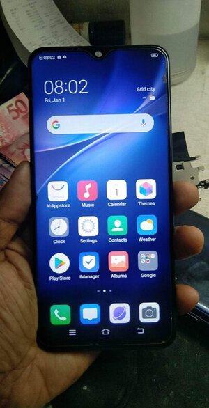

Slowly but surely lng po tyo salamat
Give and take para everybody. Happy
