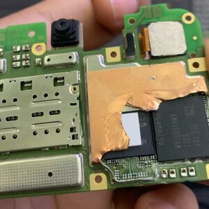

VIVO Y1s (vivo 2015) pattern and frp via UnlockTools
Procedure:
=>OPEN UNLOCK TOOL
=>click mediatek tab
=>hit costum Reloader | EMI
=>select vivo Y1s [PD2014F]

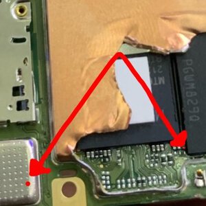

=>Then click format data and choose method 3 - Quick format
=>TESTPOINT
6736D0EA-FBE8-4595-AA33-D1B4E8E40B29 (3).jpeg6736D0EA-FBE8-4595-AA33-D1B4E8E40B29 (2).jpeg
DONE!!!!!!!!!
