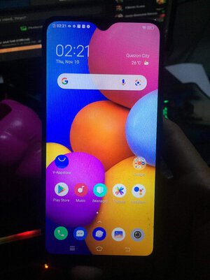

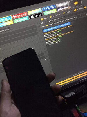

VIVO Y1S REMOVE PASSCODE DONE VIA UNLOCKTOOLS.
PROCEDURE.
OPEN UNLOCKTOOS
SEARCH VIVO Y1S
CLICK NEW SEC PATCH META MODE
CLICK FACTORY RESET EMMC
HOLD VOLUME UP AND DOWN THEN PLUG CABLE.
WAIT NYO LNG MINSAN 15 TO 20MINS MATAGAL KALA MO HANGLOGO
PAG MATAGAL NA RESTART NYO PHONE NYO TUTULOY YAN OR HARDRESET NYO PO
I HOPE MAKATULONG MGA SENESHARE KO
