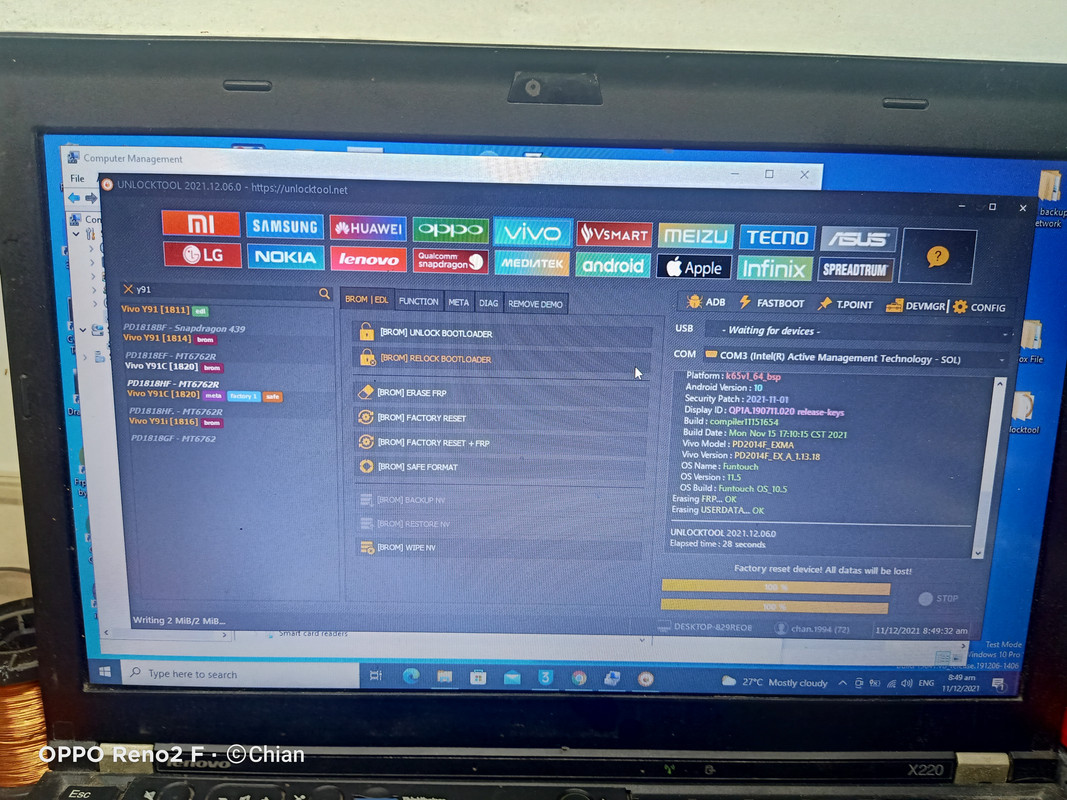

First open lang po and unlocktool click (Vivo) and search Vivo Y91 [1814] and click [BROM] FACTORY RESET + FRP then turn off phone and saksak usb lang po (No boot key)

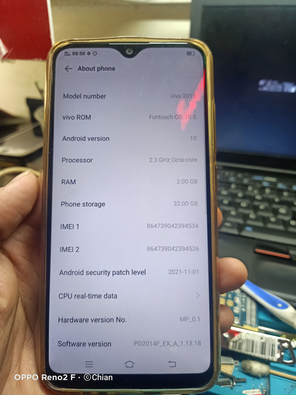

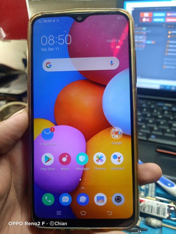

At heto naman po result ko.
