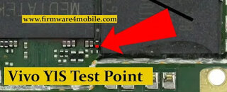

vivo y1s / (vivo 2015) via cm2mt2
baklas mo vivo y1s tp. w/out battery
ito
1. cm2mt2 0_Base / Base v2112
2 service FULL FACTURY ( WIPE + FRP )
3 Reset Setting / Format FS
tested ko na po, refence lang,
ito gamit ay smart reset pero ala nangyari.....( https://www.youtube.com/watch?v=fxank7-QeCE )
dka matatakot baka logo or dead kasi FULL FACTURY ( WIPE + FRP ) ginawa mo...
thank you;)
