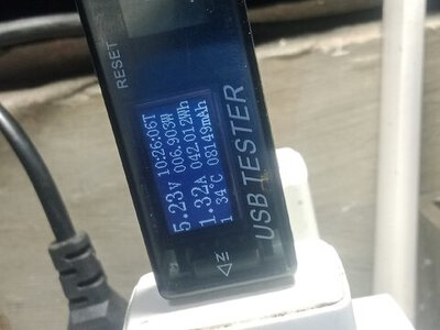

step 1 tester diode mode test vbat line reading 0.001 both line
step 2 saksak sa dc power supply may current agad kahit di pa press power botton reading 0.200A

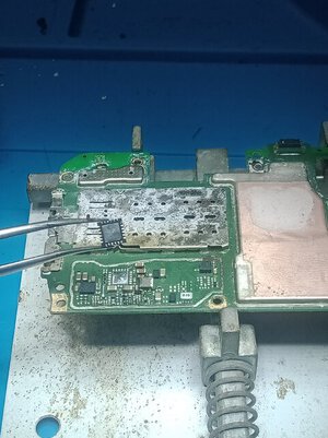

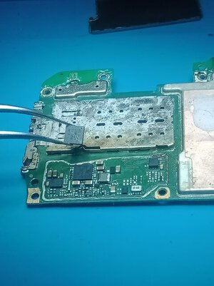

step 4 baklas i.c cover then use rosin/insenso then on power supply. ayun charging i.c unang uminit
step 5 replace new charging i.c done.

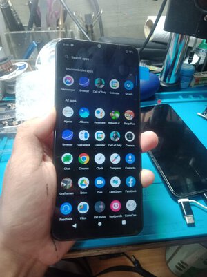

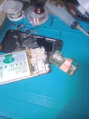

step 6 ok na nabuhay na then replace LCD na din kc nababad sa baha.
di ko na pic lahat ng method nanonood si tumer eh nakaka ilang hahahah
