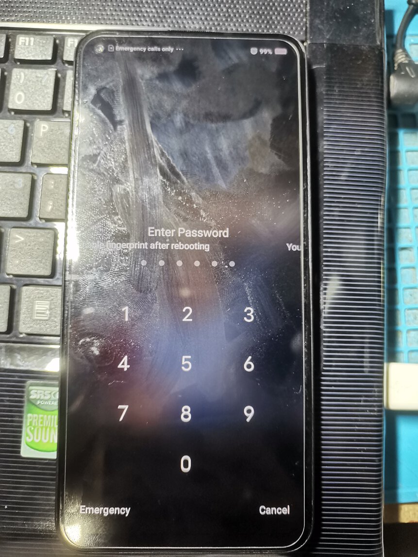

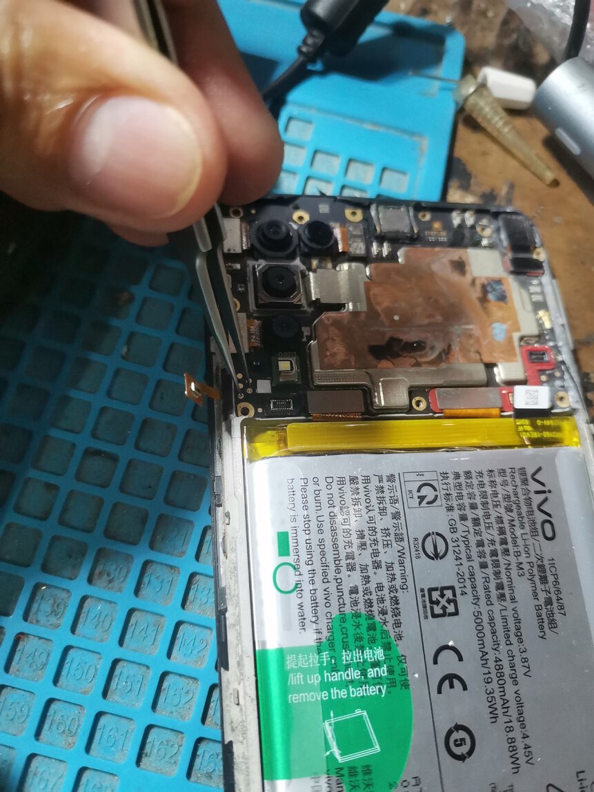

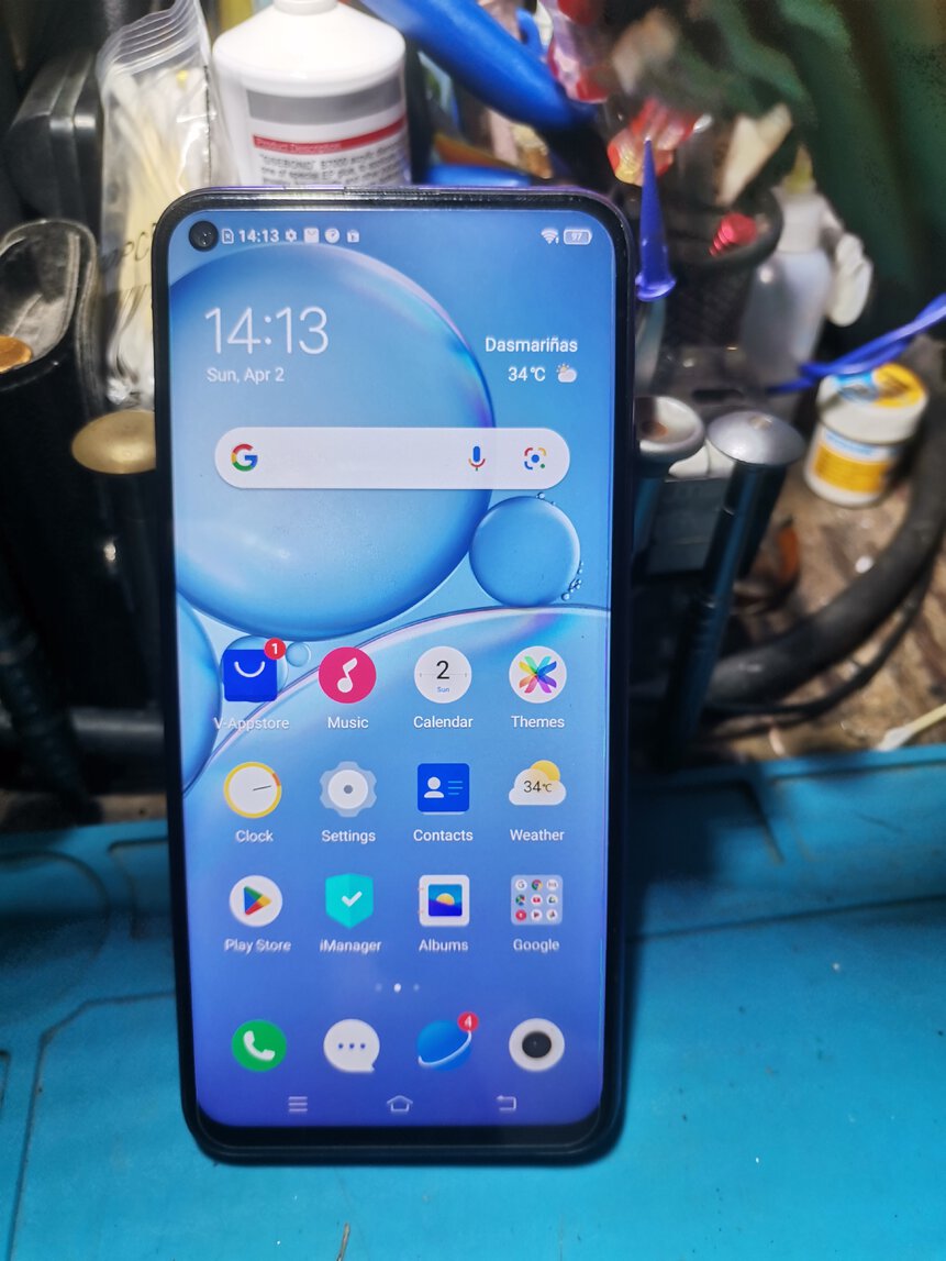

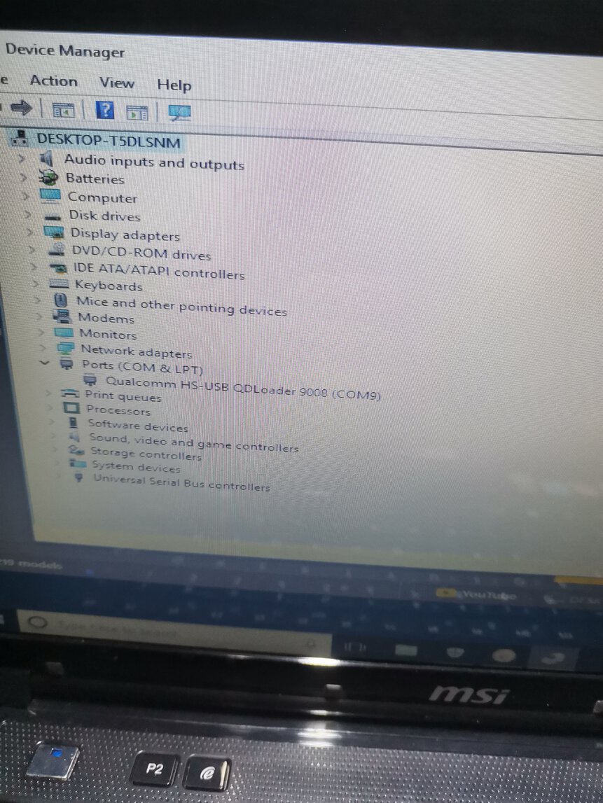

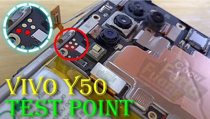

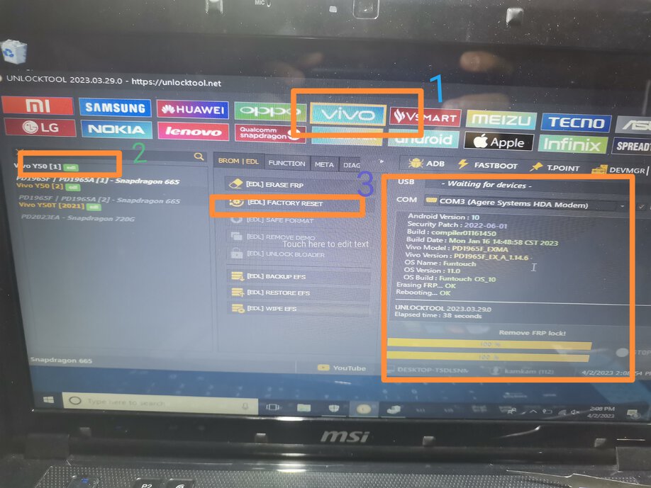

dranreb21 Registered Joined Oct 8, 2017 Messages 188 Reaction score 201 Points 201 Location Dasmariñas, cavite Apr 2, 2023 #1 VIVO Y50 1935 Password done open si UT sundan nyo nlng po sa Picture baklas unit para sa Testpoint sa frp ganun lang din click lng Erase FRP 100% success Sana makatulong sa inyo ka pinoytech
