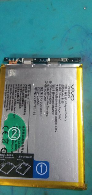

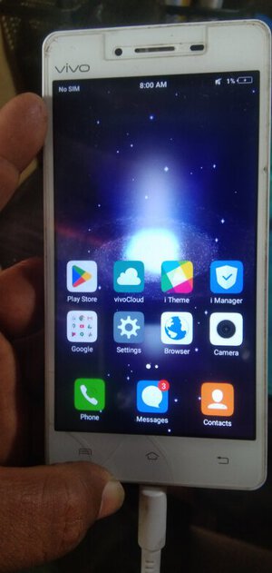

Darwinred25 Registered Joined Nov 17, 2021 Messages 55 Reaction score 42 Points 1 Location marilao bulacan Jan 7, 2023 #1 Ayaw mag charge Namamatay kpag inalis charger Tanggal kuto lng ginawa ko Successful GODBLESS TO ALL MGA BRO
J j4m2_6 Registered Joined Apr 27, 2021 Messages 1,435 Reaction score 2,965 Points 341 Location La Union ™️ ( Region 1 ) Jan 7, 2023 #2 tested tlga yn fuse remove or jumper done...
Darwinred25 Registered Joined Nov 17, 2021 Messages 55 Reaction score 42 Points 1 Location marilao bulacan Jan 8, 2023 #3 Hi-Tech said: tested tlga yn fuse remove or jumper done... Click to expand... Yung agad target ko bro pero kung hindi nag OK palit battery na cguro ako
