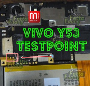

cto:
test point
> open qfil load fw test point ok lng kahit nka unplug yung batt hintayin lng matapus mag flashing

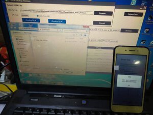

imie repair:
watch this video https://www.youtube.com/watch?v=RkjXFpQGNc0
cto:
done!
