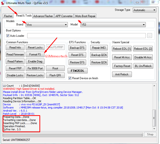

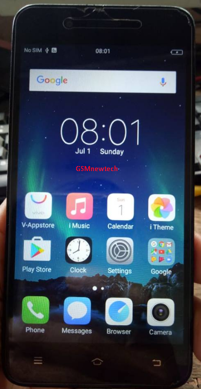

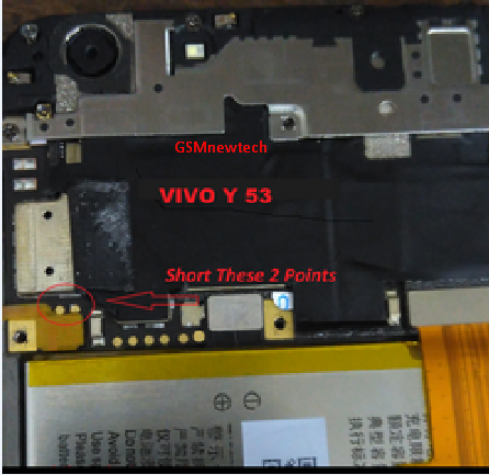

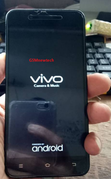

jhun1308 Registered Joined Jun 11, 2016 Messages 285 Reaction score 116 Points 1 Location naga city Jan 28, 2019 #1 vivo y53 1606 hang logo fix by nck umt qcfire update daw sana ni tumer kaso nawalan ng net pag open nyan hang nalang unit done saa format lang kay nck umt qcfire eto po testpoint para mag connect DONE for reference only
