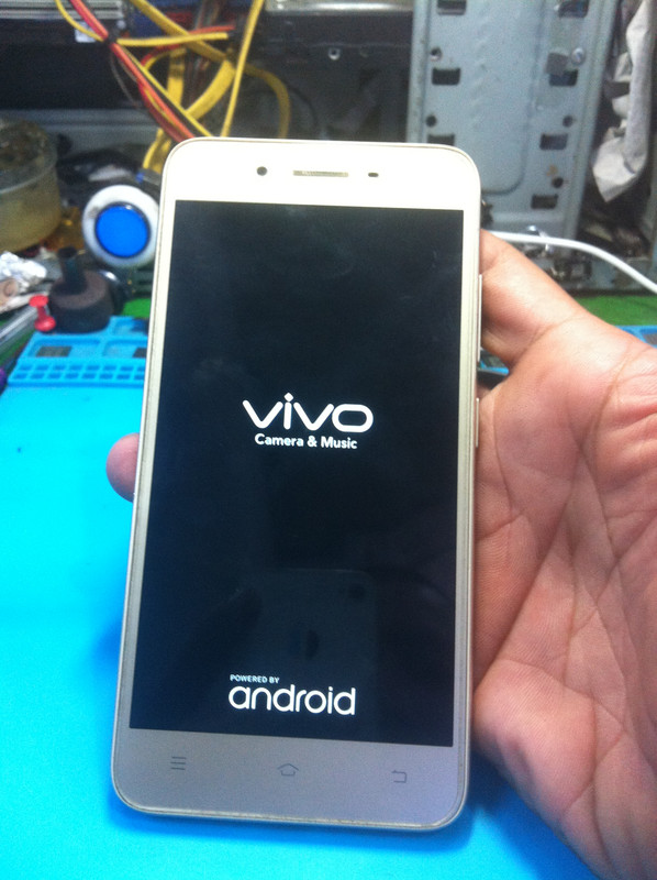

Good day share ko lang po.
Model: Vivo Y53 1606.

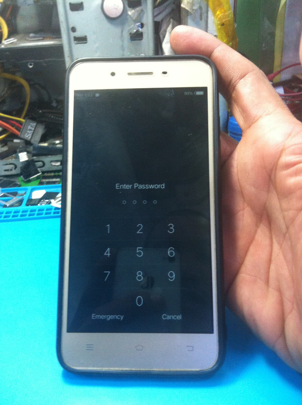

Problem: Pattern Lock.

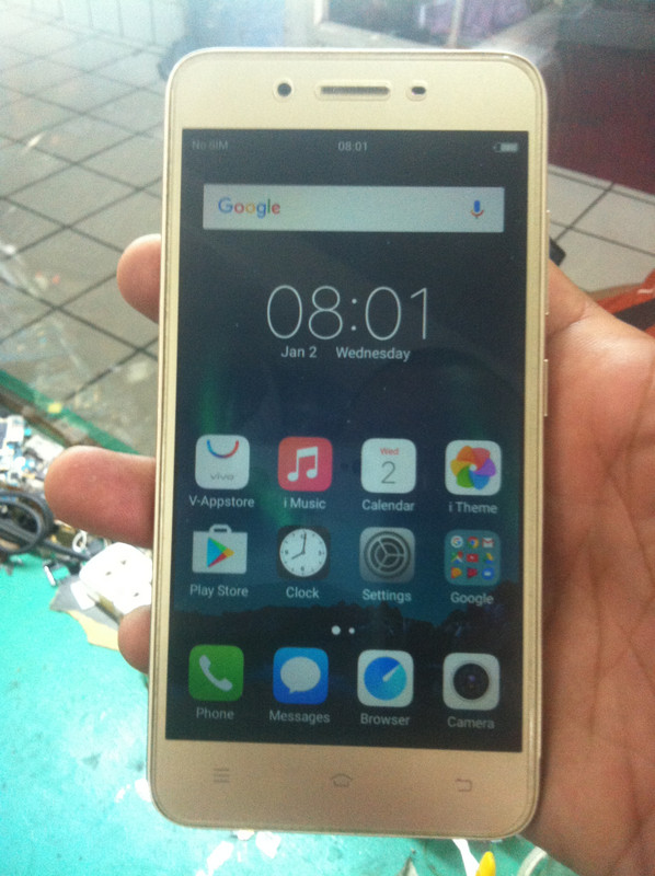

Solution: Factory Reset at erase frp

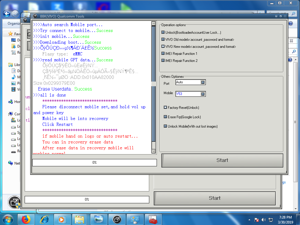

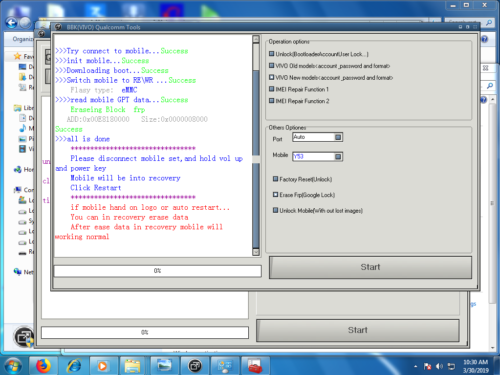

Procedure:
* Open MRT 2.60
* Tick VIVO_QC tab
* Check VIVO New models<Account pasword & Format>
* Select Y53 Model
* Check Factory Reset[Unlock] at erase frp
* Hit Start
