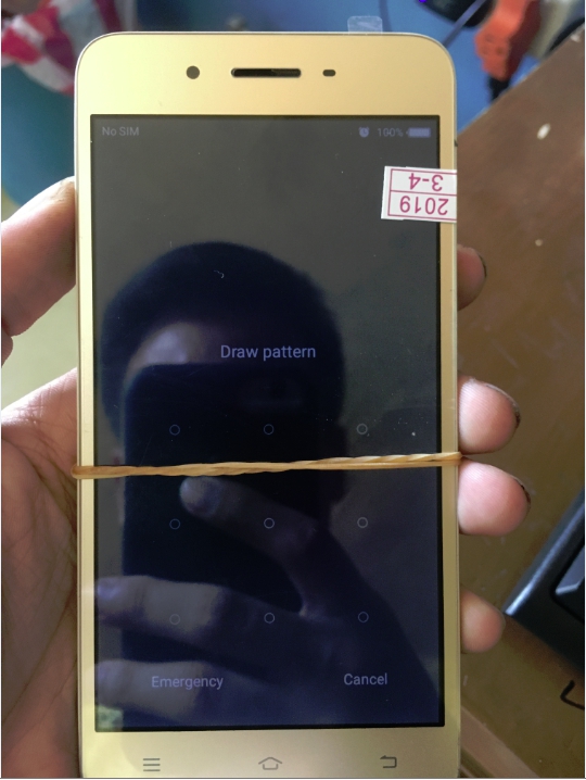

UNIT: Vivo Y53
ISSUE: Forgot Password FRP

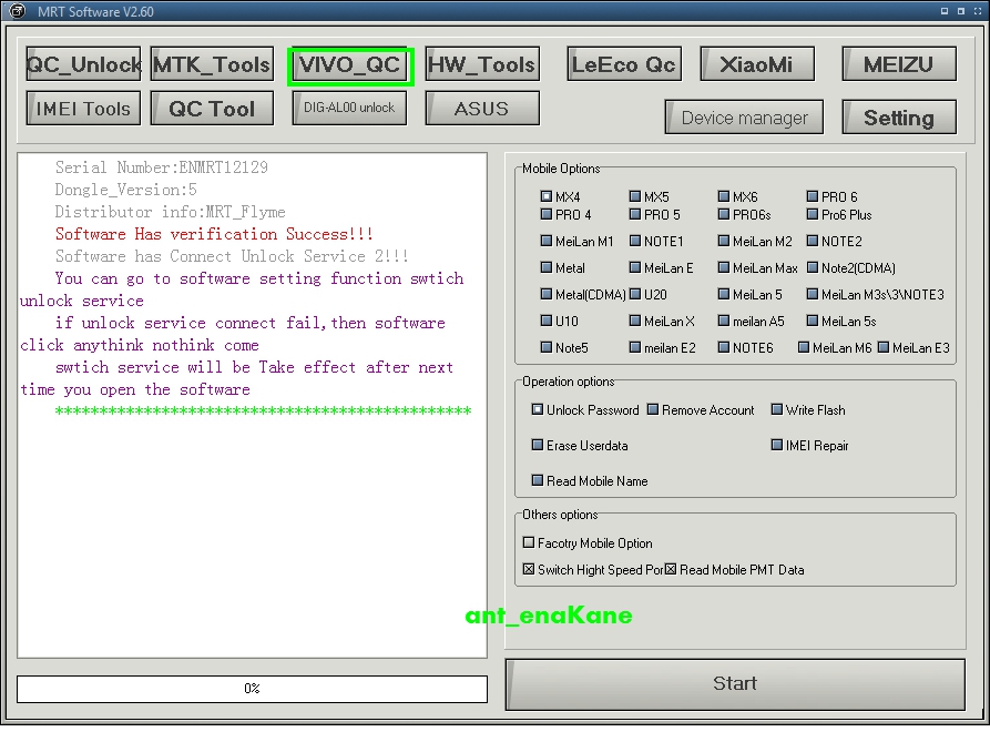

Off Unit
Open MRT 2.60
Click VIVO QC
Select Vivo New Models
Select Model: Y53

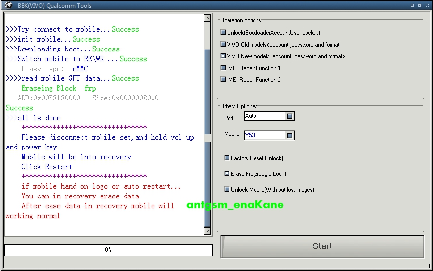

Select Erase FRP

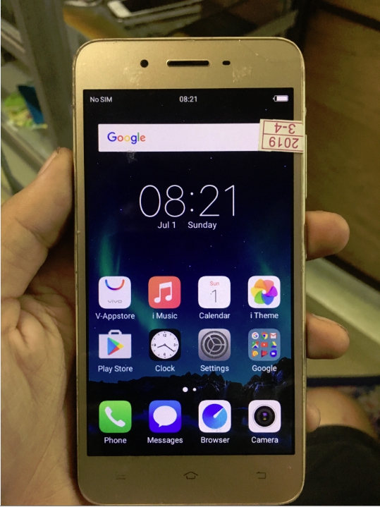

*pagtapos na ma success ang format kala ko DONE NA, nag hang on logo na lang sya, hinard reset ko lang mga boss, ayun tumuloy na
DONE !!!
