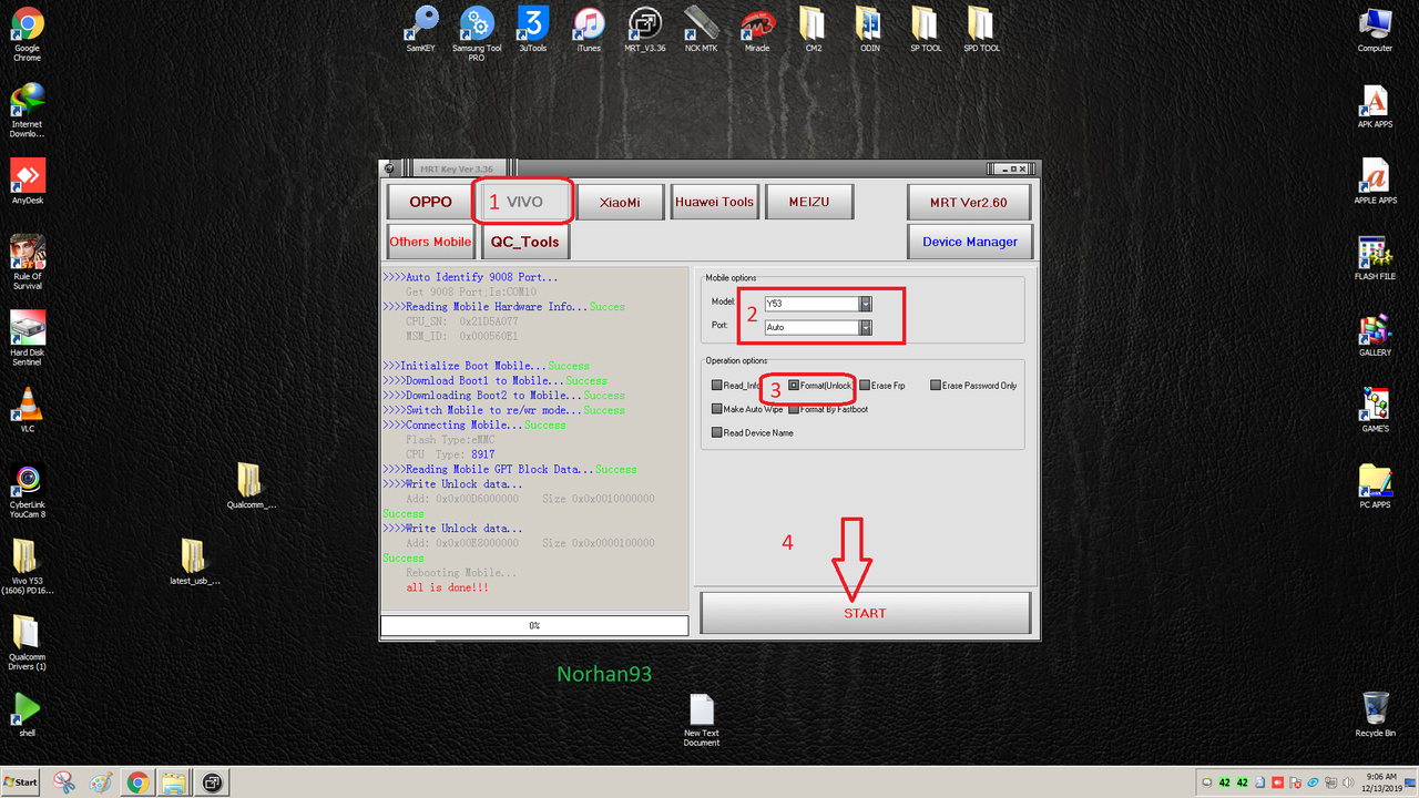

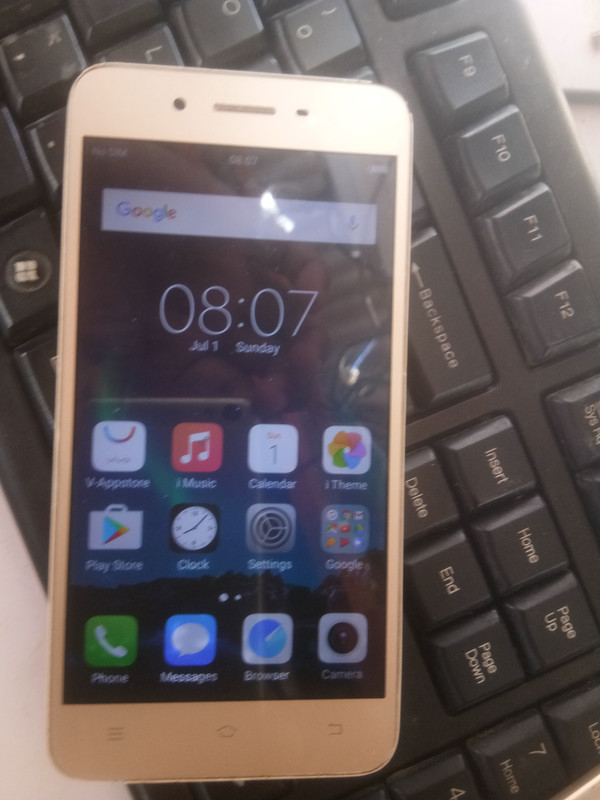

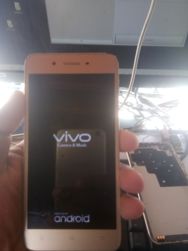

unit : vivo y53
status : auto reboot

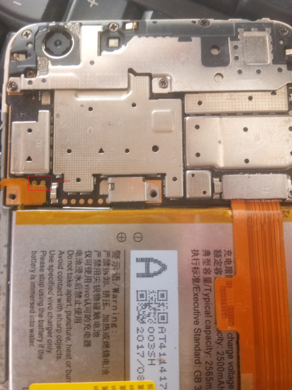

procedure : format unlock via mrt key test point
-tanggalin ang battery
-saksak usb & testpoint
-click start botton
at hintayin matapos at wag kalimutan i install ang driver 9008
see the ss
