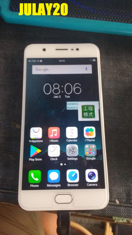

VIVO Y69 1714 password and frp done sa free sof

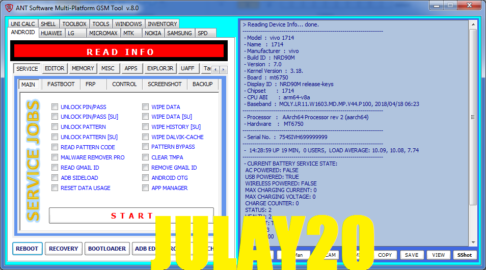

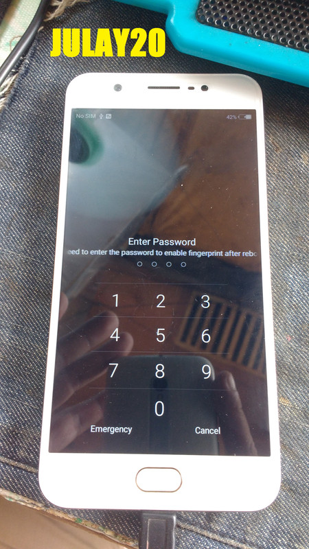

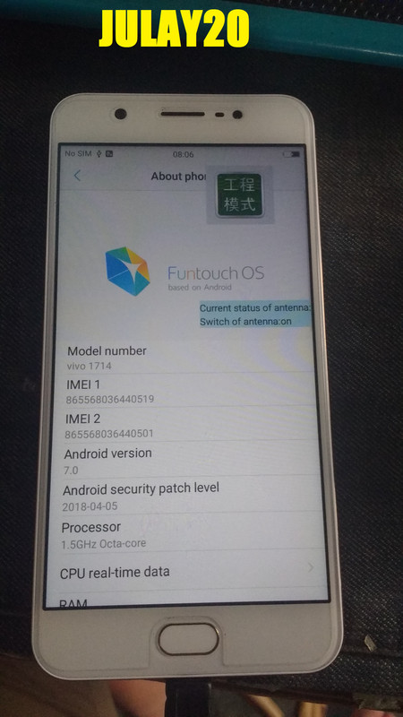

-na pag laroan ng bata kaya ayaw na ma boksan ang password kaya ito ginawa ko read info ko mona gamit ang antsoft natin
INFO

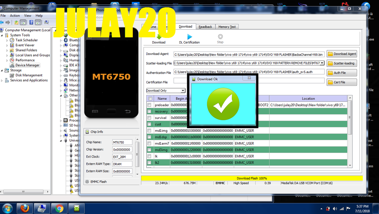

tapos hanap ako file meron namn dito sa tahanan basta alam mo lang pano mag hanap dito ko na koha yung file ko ohh
DOWNLOAD: HARE !
sondan u lang ito

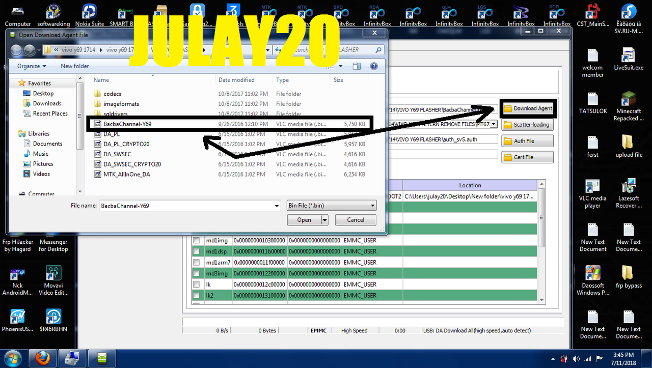

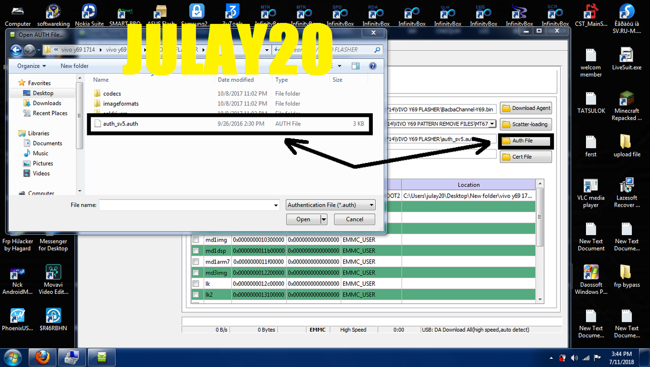

press CLRT + ALT + S
para lumabas ang selection bar para sa Authentication file.. then load mo lng auth_sv5.auth
load mo rin BacbaChannel-Y69 as download agent
load scatter file
NOTE:
dapat naka uncheck ang preloader
click download button and wait until finished.. oreg !!! CL TOTO KALBO

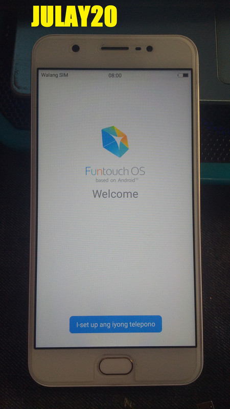

done

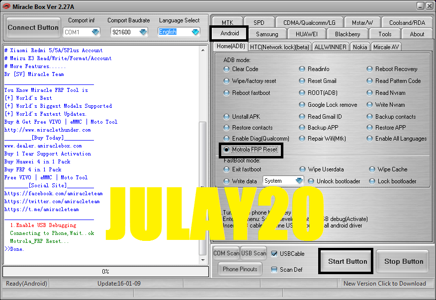

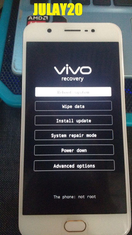

sa frp namn sonadan mo to

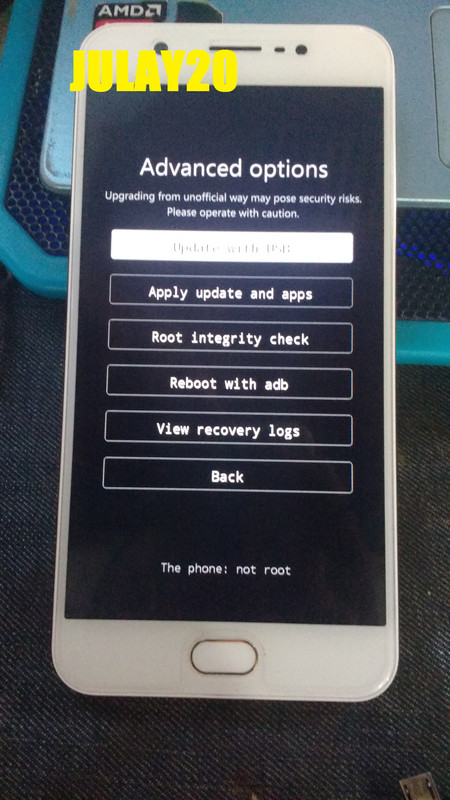

Put Phone in Recovery mode by pressing Vol down / power pag vibrate bitawan power button
Ito lalabas. select recovery by pressing volume down at power for enter
INFO
Code:
> Reading Device Info... done.
- Model : vivo 1714
- Name : 1714
- Manufacturer : vivo
- Build ID : NRD90M
- Version : 7.0
- Kernel Version : 3.18.
- Board : mt6750
- Display ID : NRD90M release-keys
- Chipset : 1714
- CPU ABI : arm64-v8a
- Baseband : MOLY.LR11.W1603.MD.MP.V44.P100, 2018/04/18 06:23
- Processor : AArch64 Processor rev 2 (aarch64)
- Hardware : MT6750
- Serial No. : 754SIVH699999999
- 14:28:59 UP 19 MIN, 0 USERS, LOAD AVERAGE: 10.09, 10.08, 7.74
- CURRENT BATTERY SERVICE STATE:
AC POWERED: FALSE
USB POWERED: TRUE
WIRELESS POWERED: FALSE
MAX CHARGING CURRENT: 0
MAX CHARGING VOLTAGE: 0
CHARGE COUNTER: 0
STATUS: 2
HEALTH: 2
PRESENT: TRUE
LEVEL: 43
SCALE: 100
VOLTAGE: 3849
TEMPERATURE: 350
TECHNOLOGY: LI-ION
> All done.
DOWNLOAD: HARE !
sondan u lang ito
load scatter file
NOTE:
