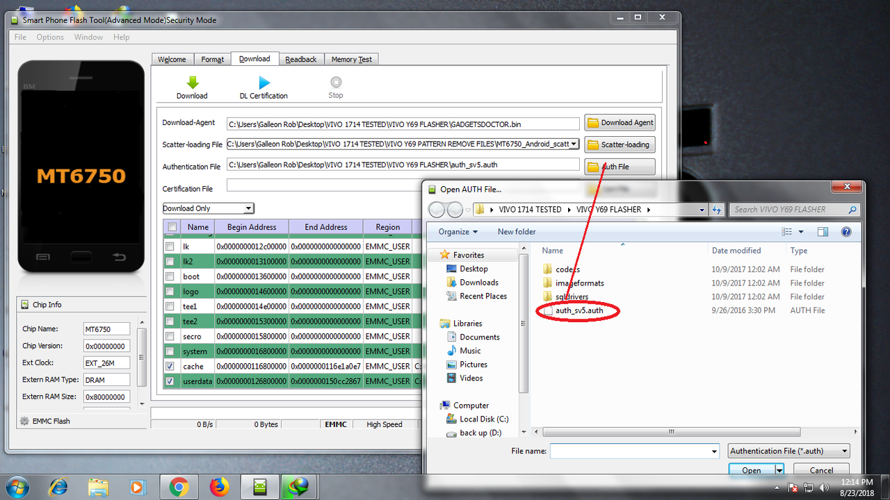

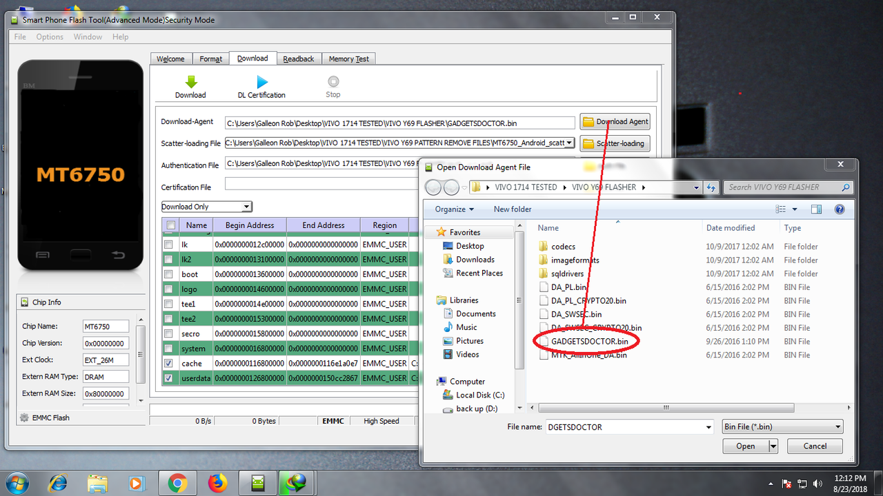

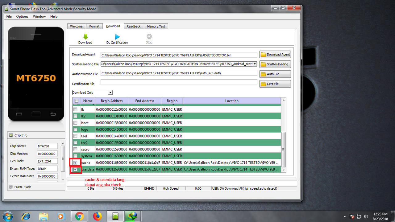

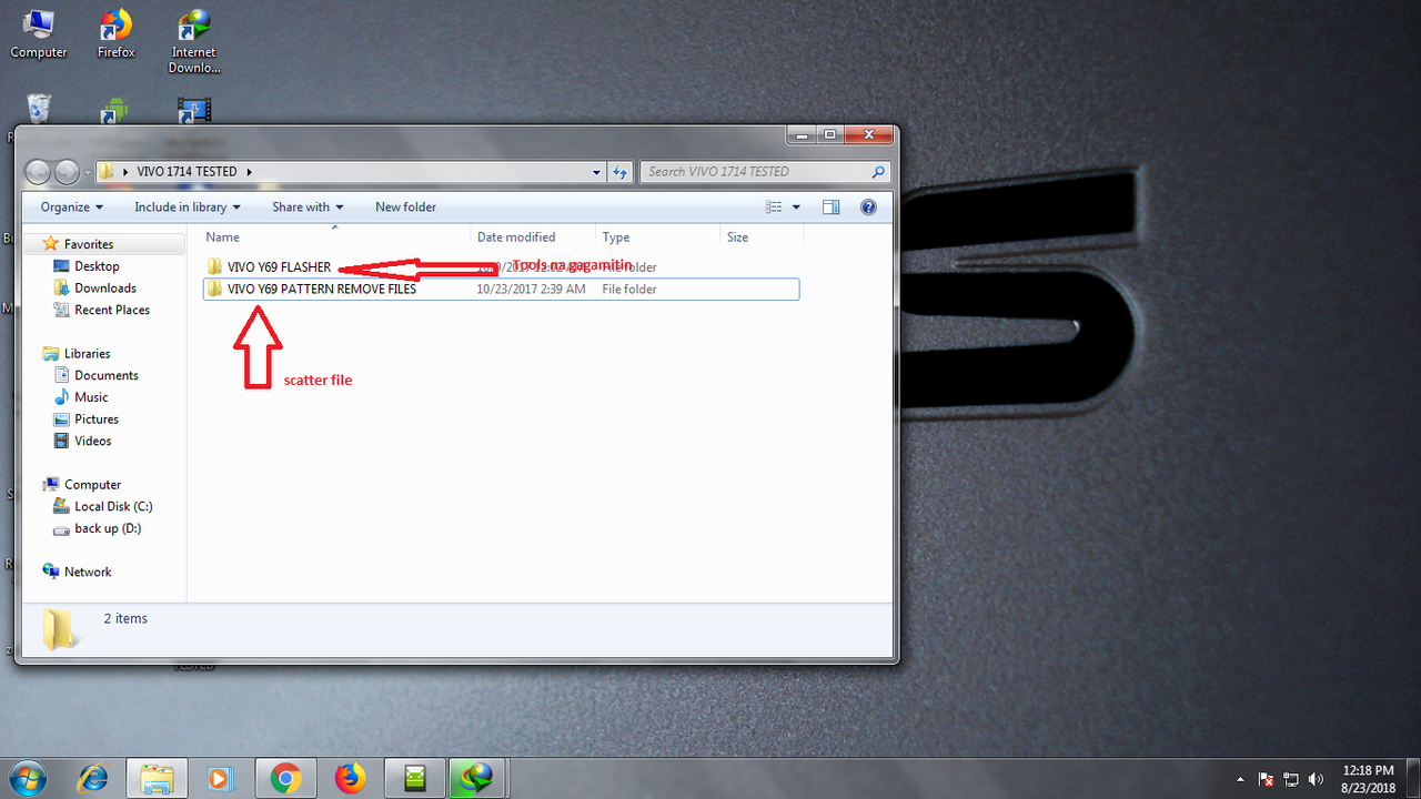

Gud day mga ka ANTECTH share ko lng vivo y69 1714 password & frp lock.​
Dload 1st.------>Tools & Firmwares
SS:

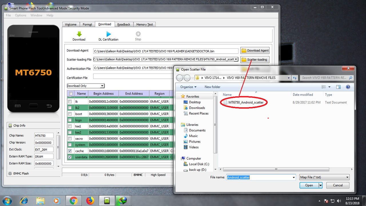

then pag na load muna lahat proceed kna sa flashing:D

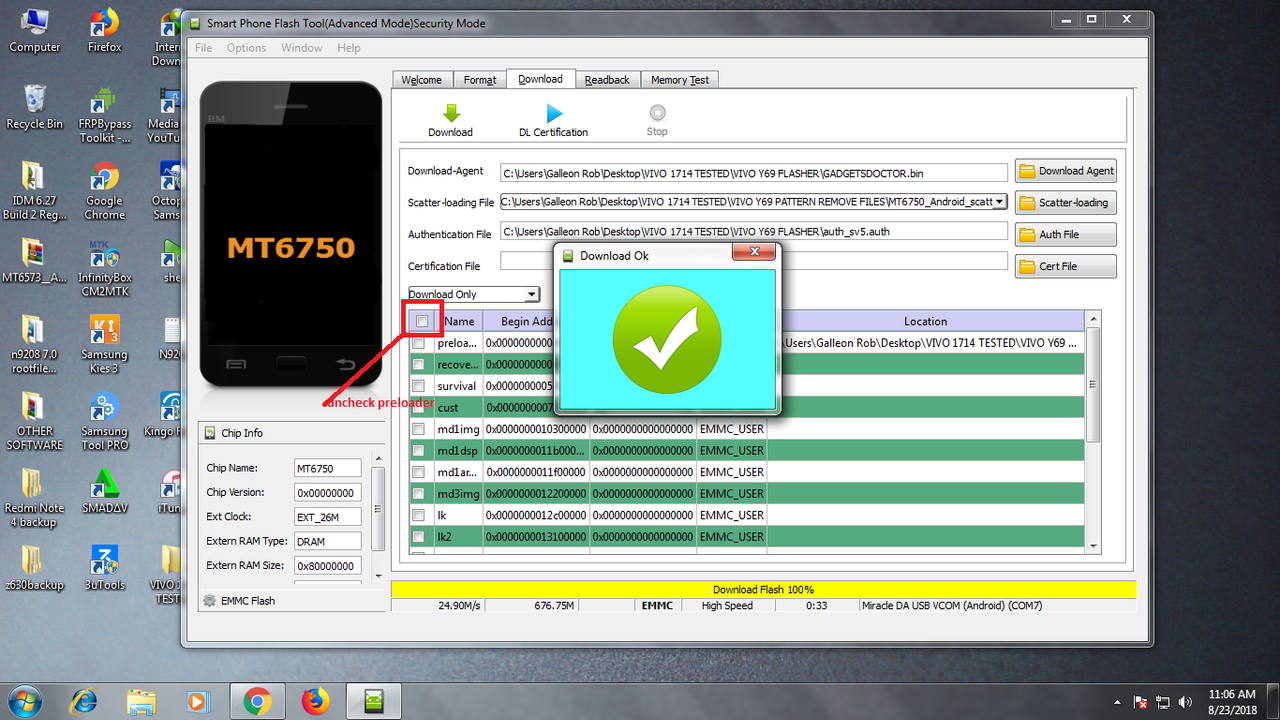

hold v+&v- then insert usb cable,
hantayin lang matapos ang flashing, then power on ang cp, medyo matagal ang boot up. wag kabahan hindi yan hang on logo antayin mo lng,
SS:

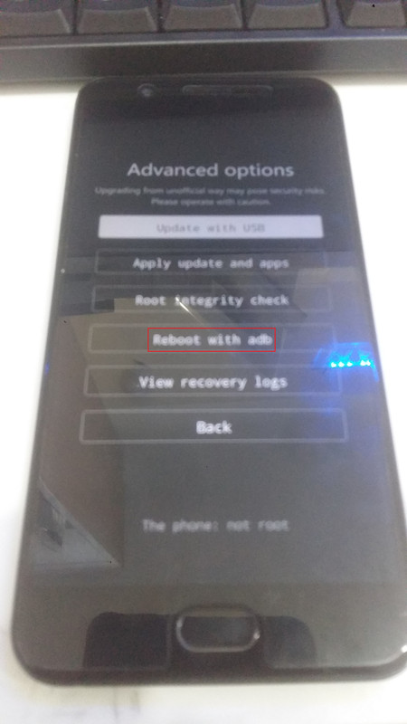

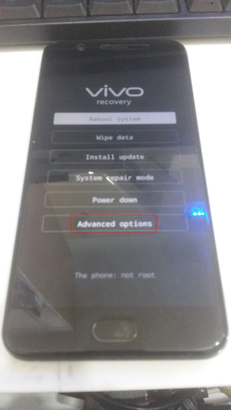

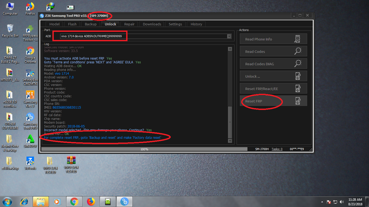

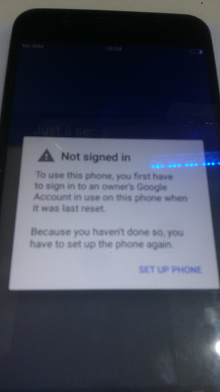

hindi pa tapos yan may google account pa:((
para nman sa google account kaylangan e ADB mode ang cp, at gamit c z3x para ma remove c FRP
press power+volume up to enter recovery
image hosting websites
saka natin remove ky z3x
select model J700H

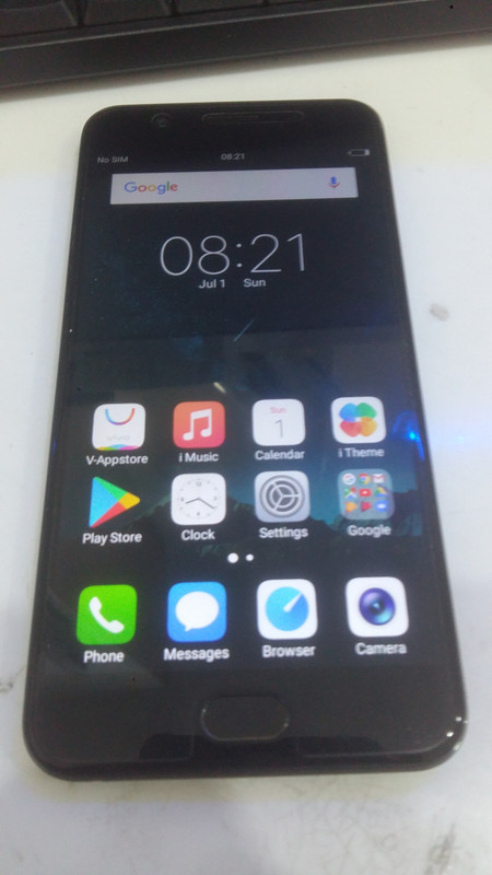

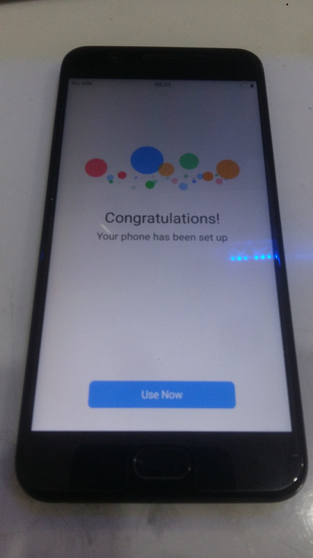

FINISH PRODUCT.
