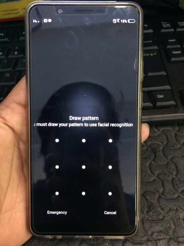

Share ko lang 'tong gawa ko mga boss vivo y71 napakialaman daw anak nya di na mabuksan.
Eto sya nung naka pattern lock pa..

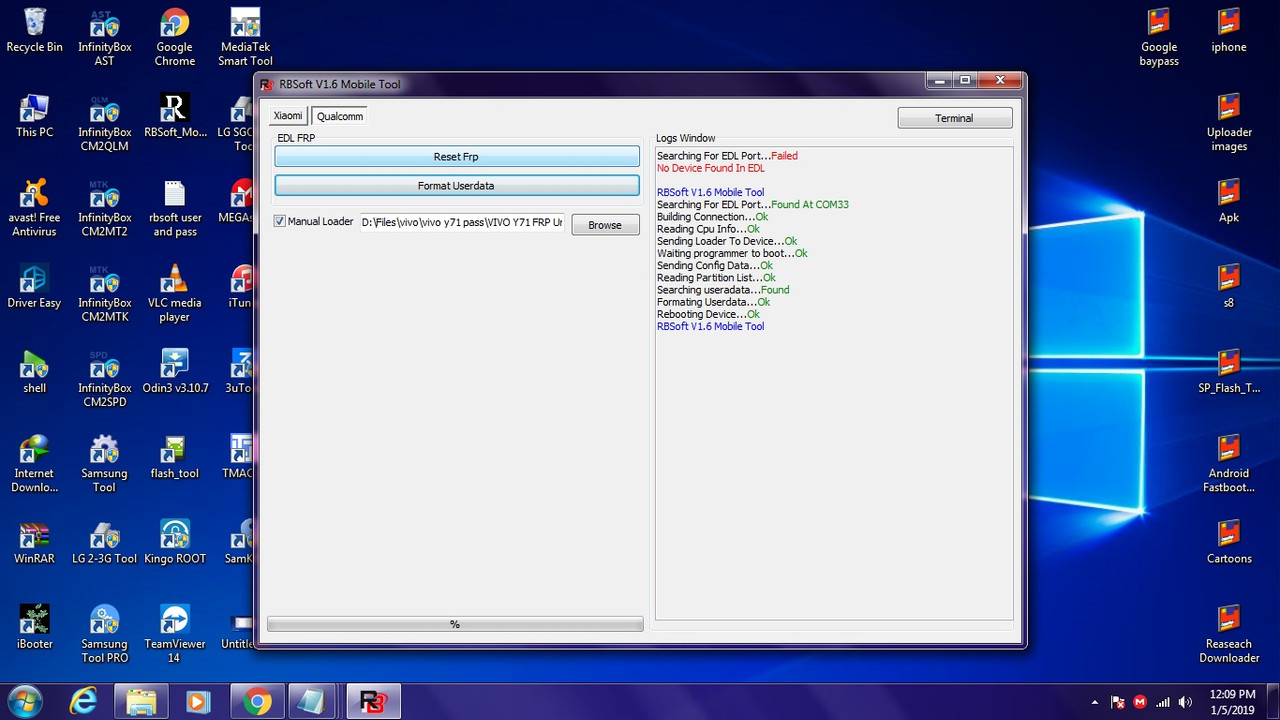

Dito ko kinuha yung loader kay boss richard1982 https://antgsm.com/showthread.php?t=176930&highlight=VIVO+Y71+FRP+PASSWORD

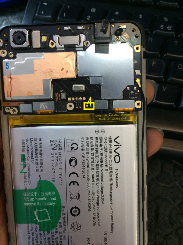

Una need baklasin ang unit para matespoint para madetek ng computer, Sundan lang nasa picture
Kung may FRP same procedure lang Click Reset FRP

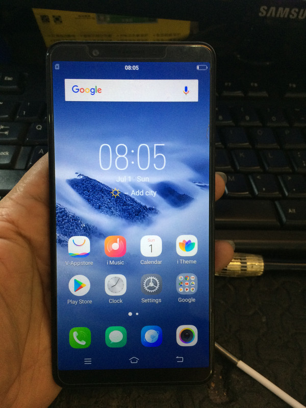

Done dalandan sana makatulong
