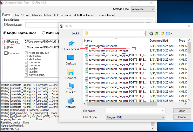

tools to be use
1.umt qcfire 4.3
2.tested firmware >>>HERE<<<
PROCEDURE
open umt qcfire

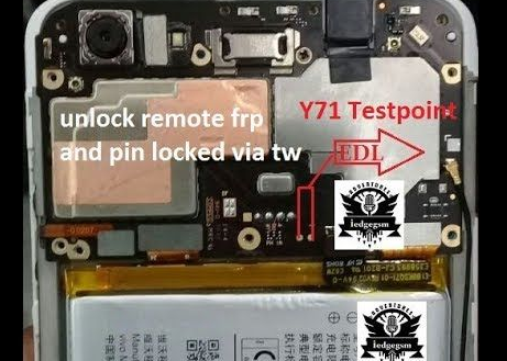

BAKLAS UNIT FOR TESTPOINT
BAGO ETESTPOINT TANGGALIN MO MUNA BATTERY FOR SAFETY
PRESS FLASH DEN TESTPOINT SABAY SALPAK USB GANG MADETECT SABAY BITAW TESTPOINT DEN W8 FOR FINISH AND YOUR DONE.

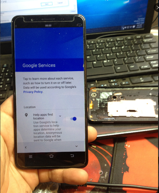

salamat tested sir
