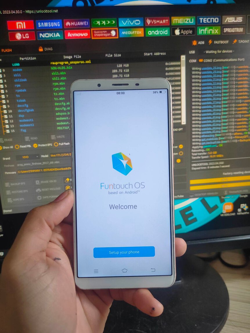

NAG BOOTLOOP AFTER MAG REMOVE NG PASSWORD

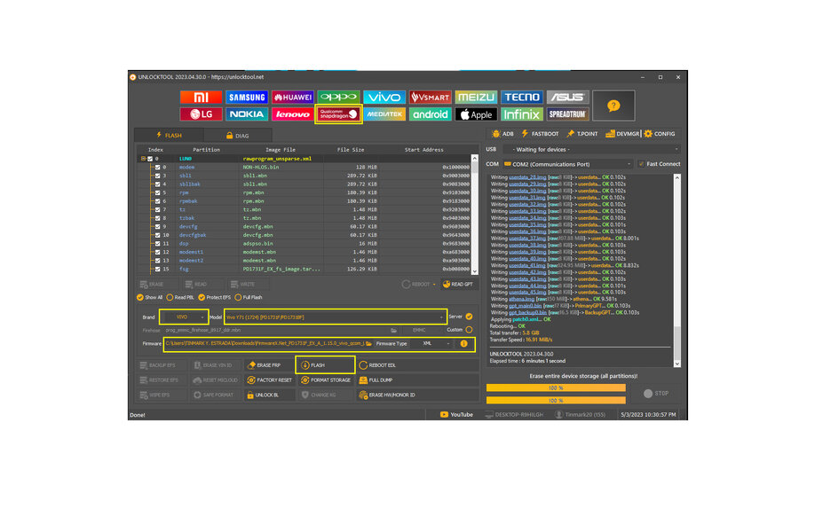

SOLUTION:
1. DOWNLOAD FIRMWARE HERE https://androidfilehost.com/?fid=6006931924117929193
2. OPEN UNLOCKTOOL THEN CLICK QUALCOMM SNAPDRAGON
3. CLICK SERVER DIN CHOOSE VIVO FOR BRAND AND Y71 FOR MODEL
4. EXTRACT THE DOWNLOADED FILES TAPOS OPEN MO SA FIRMWARE.
5. CLICK FLASH THEN WAIT UNTIL DONE.
HOPE MAKA TULONG
