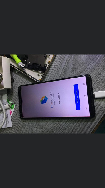

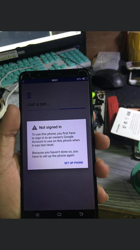

vivo y71 hang logo with
frp remove MRT 3.95
HARD RESET KO
update mo sd card
waiting to 3mints
then
procedure

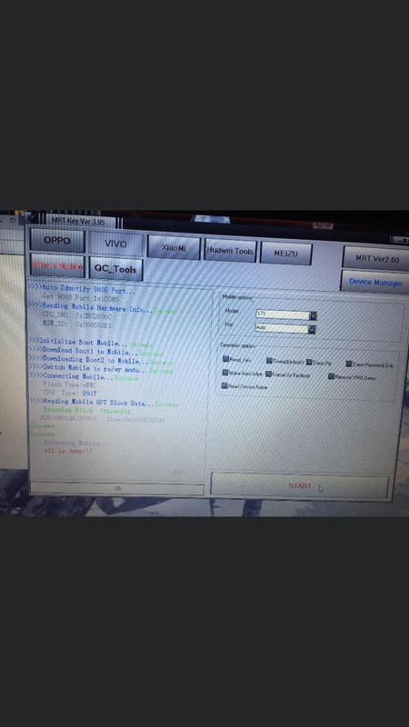

opin mrt.3.95
select tab vivo
click vivo y71
click frp remove

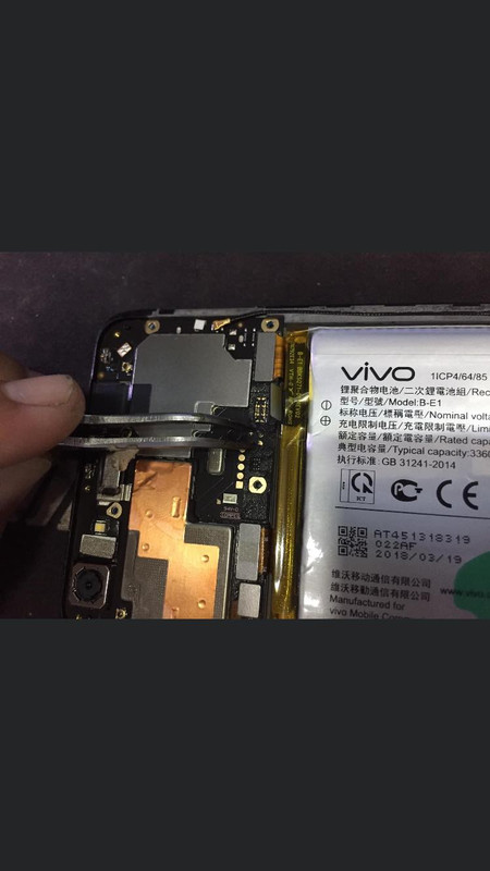

baklas unit test point
conect usb start waiting

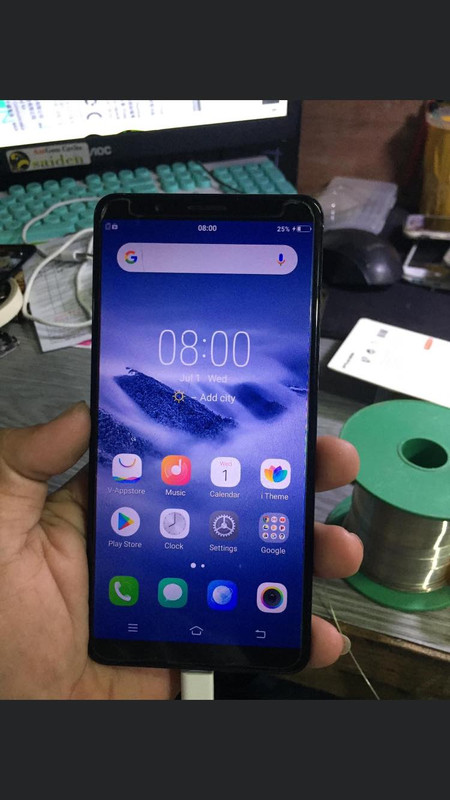

done
