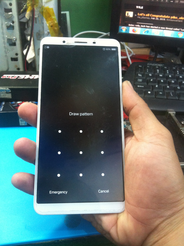

MODEL UNIT: VIVO Y71
PROBLEM: PASSWORD & FRP
ACTION TAKEN/PROCEDURE:

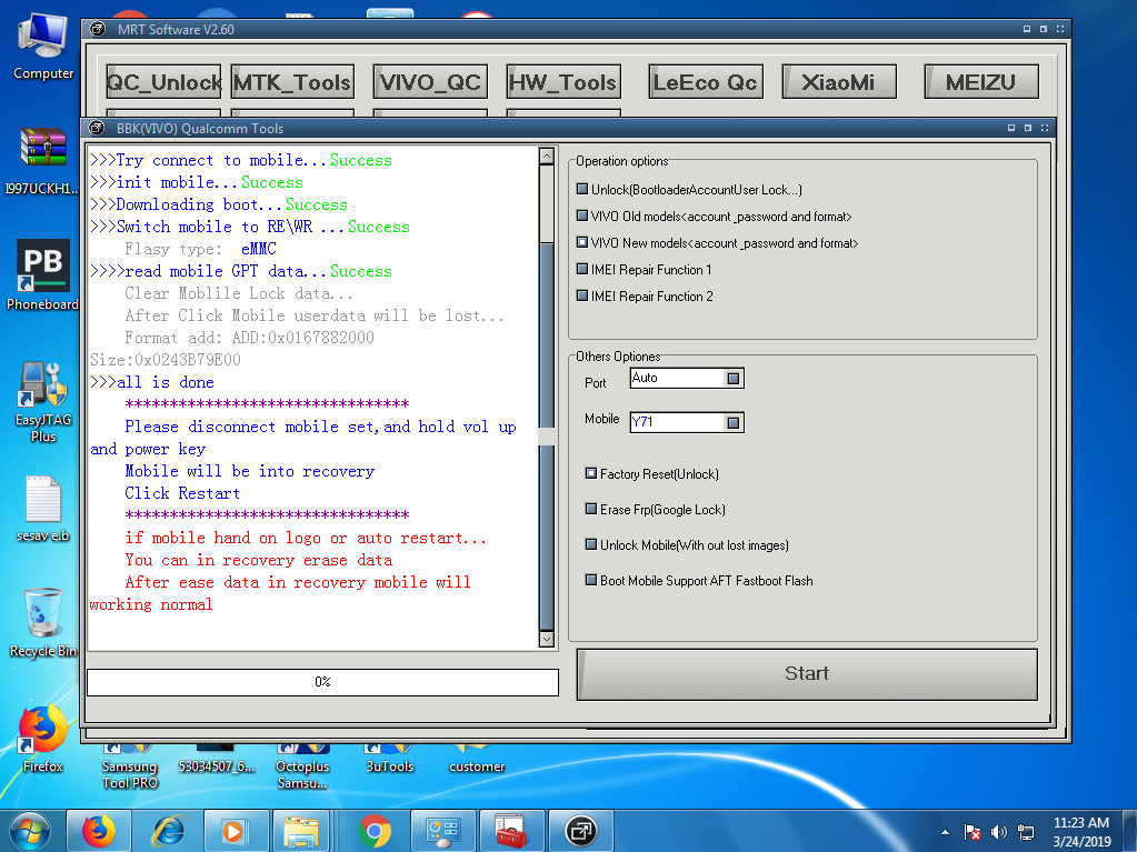

--OPEN MRT Software V2.60
--CLICK VIVO_QC ( BBK(VIVO) qualcomm tools )
--CLICK vivo new models account
--CLICK port Auto
--CLICK model y71
--CLICK Factory Reset /unlock
--CLICK Start

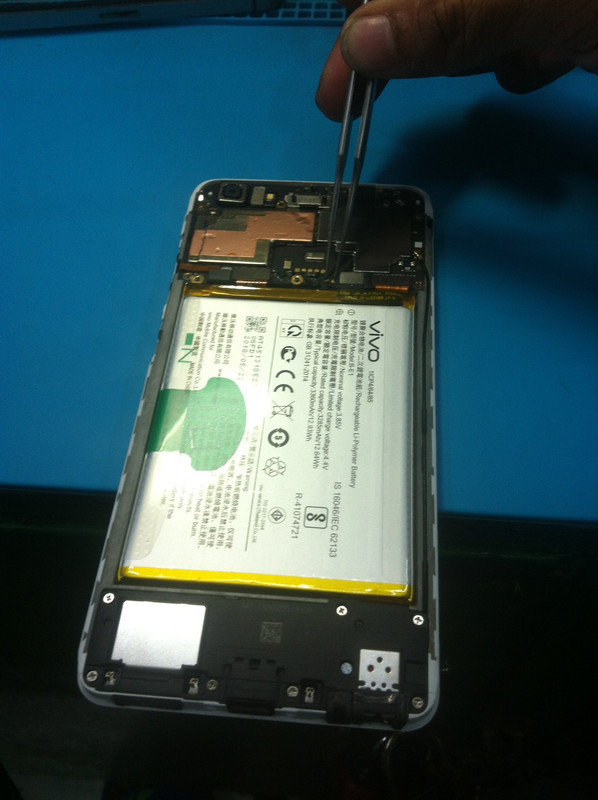

--CONNECT USB... na naka TP no ned na bootkey at no battery

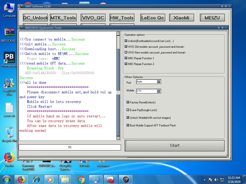

--CLICK port Auto
--CLICK model y71
--CLICK Erase Frp ( Google Lock )
--CLICK Start
