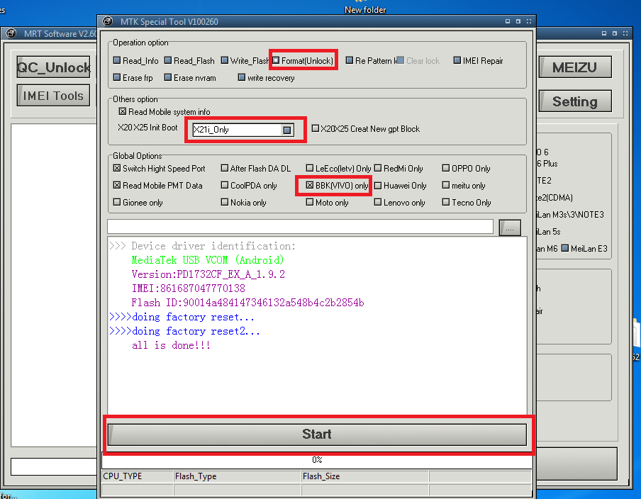

Vivo y81 [1808] Remove password and FRP in 10seconds
Procedure.
1.Power off phone
2.Go to Advance Mode- Press Vul up and power key. and Goto advance Mode and Click ADB mag rerestart and phone
3.Connect Your Phone in PC/laptop
4.Open MRT Tools v2.60
5.Click MTK_TOOLS
6.Opperation Option [Format-Unlock]
7.Other Option [X21i_Only]
8.Global Option [BBK[Vivo]only
9.Click Start and wait until All is Done
10.For FRP. Go to advance Mode again and click adb and connect pc/laptop again
11.Goto MRT Tools. and Click [ASUS] and Erase FRP in USB Debug and START BUTTON.
Sana na intindihan niu procedure ko
https://i.postimg.cc/G2x9KS0c/PASSWORD.png
https://i.postimg.cc/wBJ1yj0R/FRP.png
https://i.postimg.cc/cHSrQGb9/DONE.jpg
