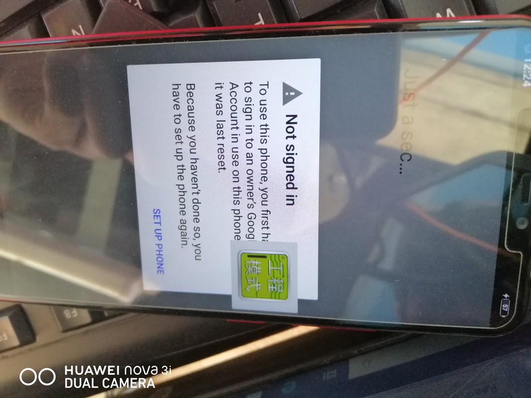

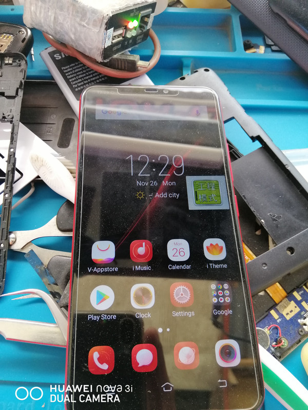

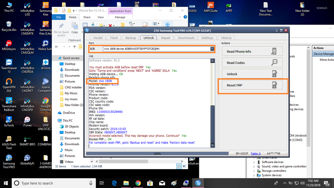

obanapHORDES Registered Joined Jun 3, 2018 Messages 80 Reaction score 85 Points 1 Location davao del norte Nov 26, 2018 #1 good day po mga ka antech.. share ko lng po... VIVO - Y81 PROBLEM - FRP OR GOOGLE ACCOUNT VERIFICATION PROBLEM.. TO ENABLE ADB GO TO RECOVERY SELECT , ADVANCE OPTION,REBOOT WITH ADB OPEN Z3X SELECT G532F AND CLICK ADB TAB CLICK FRP RESET
