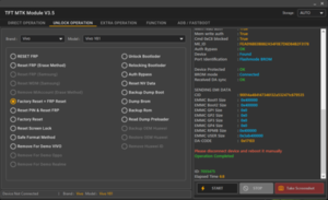

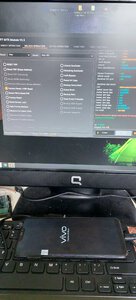

Procedure:
Open TFT 3.5
Unlock Operations
Choose: Vivo >> Y81
Select: Factory Reset + FRP reset
Press Start
Insert usb cable press volume UP & DOWN

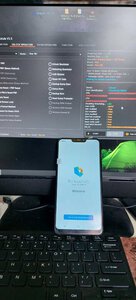

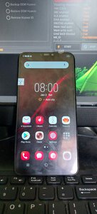

Hintayin mag operation succes
Reboot ang cellphone antayin mag boot
Sana nakatulong mga boss
