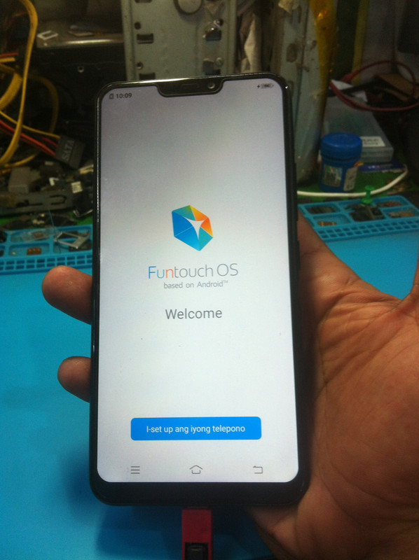

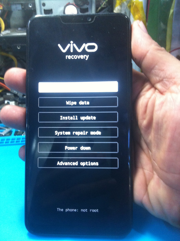

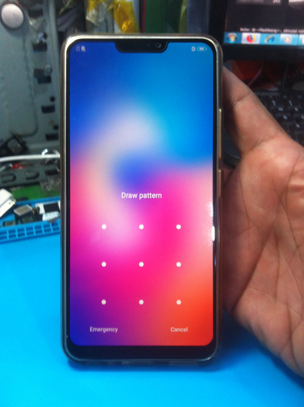

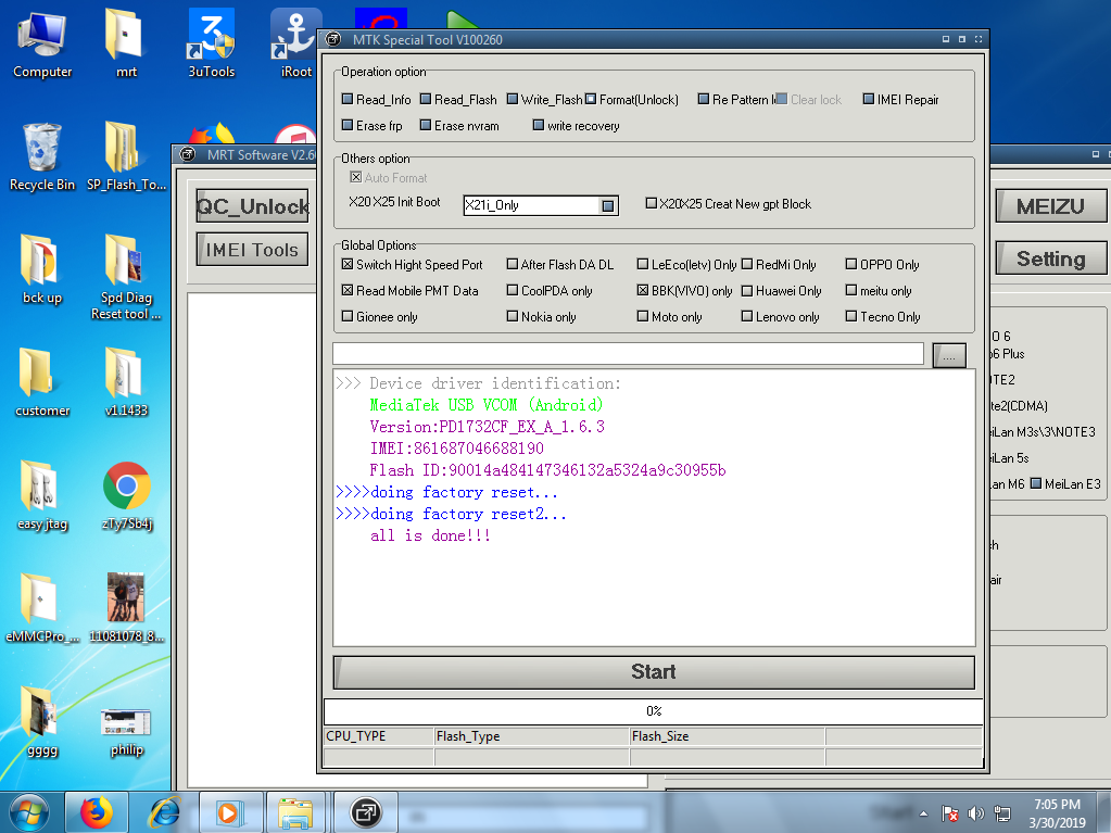

M marvin_shop Registered Joined May 24, 2016 Messages 33 Reaction score 3 Points 1 Location bacolod city Mar 31, 2019 #1 patern: procedure: Tips For Using,, HOLD Volume Up AND Power Button Sabay, Go to Recovery , Advance , Reboot ADB,, tapos mag OON yan Kailangan Naka ON yung Phone at naka Connect Si Phone Tapos Click Format!, Start Done Na Po! successful remove pattern and frp done =))=))=))
Datu Shaihadi Registered Joined Aug 7, 2017 Messages 651 Reaction score 233 Points 101 Location Maguindanao Apr 1, 2019 #2 Thanks bossing tested...100%
oxcart Registered Joined Feb 25, 2017 Messages 223 Reaction score 33 Points 1 Location Iligan City Jun 11, 2019 #3 ayaw mag connect sa aki8n boss any tips?
oxcart Registered Joined Feb 25, 2017 Messages 223 Reaction score 33 Points 1 Location Iligan City Jun 11, 2019 #4 adb driver pls
