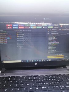

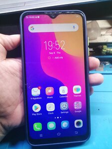

Open unlock tool
click Vivo
search
piliin ito vivo y91 (1811)
then click Factory Reset
open back cover via TP hndi nasa ma sa pic yung pag Tp nasa bandang battery sa port nya
click start anatayin matapos

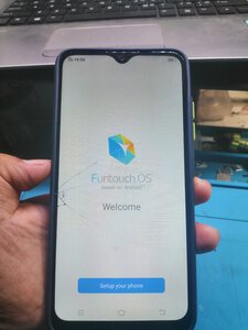

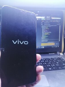

at mag automatic factory reset sya
at mag ffail e reboot mulang mejo matagal sya anatayin mo nlang
