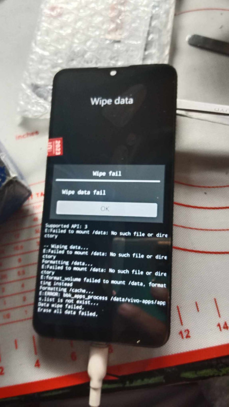

BAKLAS ANG UNIT TP MO

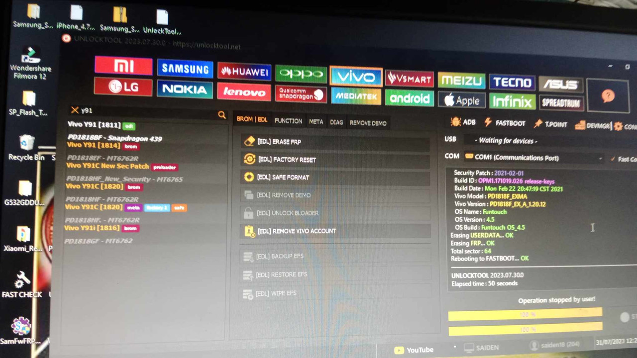

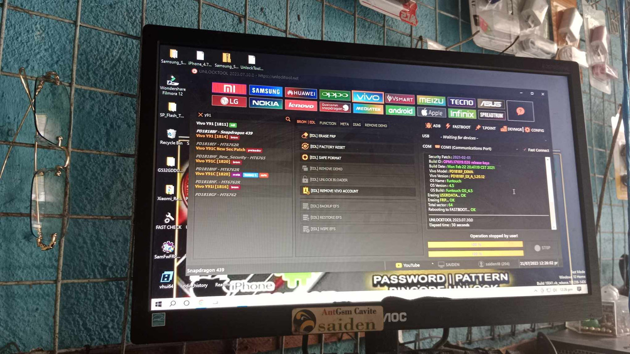

STEP 1 LOG IN UNLOCK TOOLS
STEP 2 CLICK MO VIVO TAB
STEP 3 SEARCH MO VIVO Y91 1811
STEP 4 READY MO USB CABLE

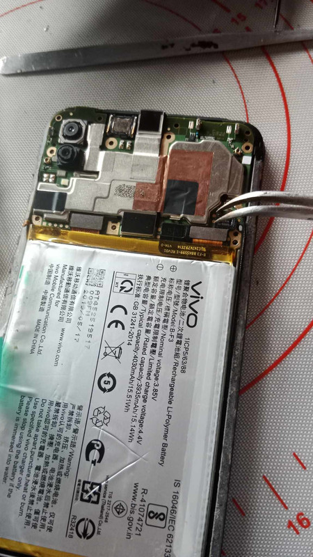

STEP 5 TP MUNA UNIT MO TANGAL CONECTOR NG BATTERY

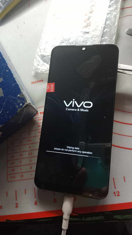

STEP 6 CLICK MO /EDL FACTORY RESET KASAMA NA UNG FRP NYA
WAIT MO HANGANG MATAPOS

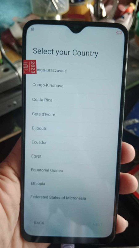

DONE FINISH
