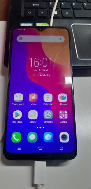

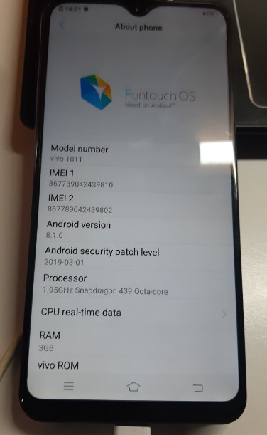

Model Name: Vivo Y91
Model Number: Vivo 1811
Android Version: 8.1.0
Chipset: Qualcomm

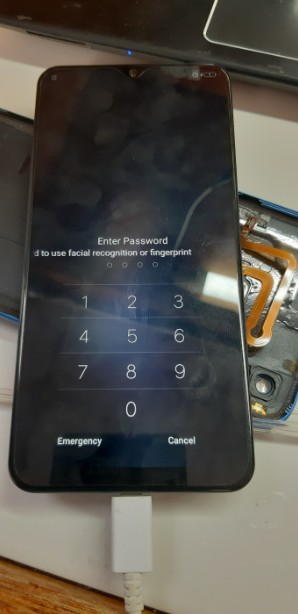

Problem: Password

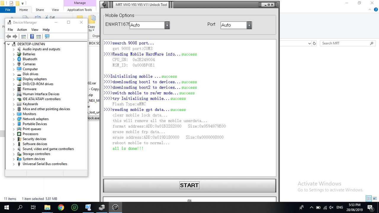

Solution: Clear mobile userdata & FRP data using MRT
Just use MRT Vivo Y93 Y95 V11 Unlock Tool

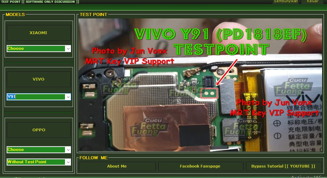

ground two points(testpoint) for 9008 ports edl mode
then press start

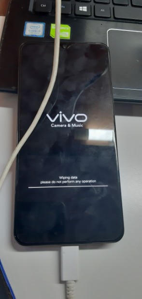

wait until performs factory reset
(result is failed just press restart phone)
wait and done. . .
For Test point, I use TEST POINT Software
