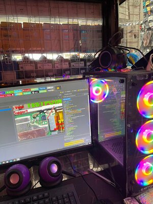

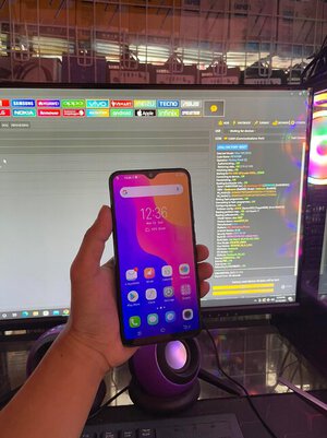

Procedure
1.select vivo
2.select vivo model y91 {1811} EDL
3.testpoint
4.factory reset
5.press volume up and down then plug the connector.
6.Same procedure pag may FRP
boss anu ba tlga TP or bootkey? pangalawang bisis na ito
