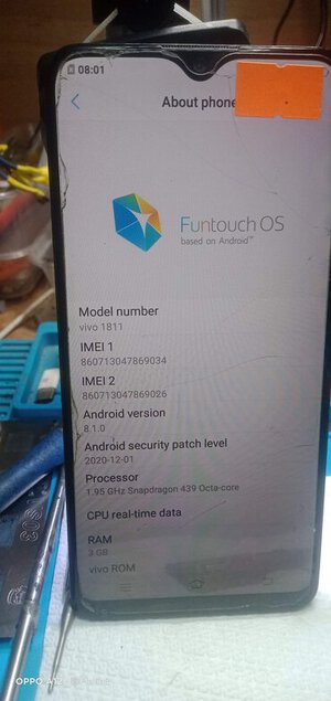

from co tech mga boss..
tanggap nya no power 0.138 power supply reading..
kaya alam na..

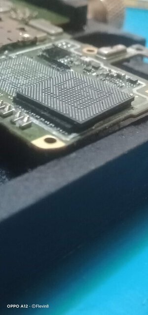

reballs cpu..
after installed cpu psu reading 0.078 low current.
sinubukan ko jtag. .

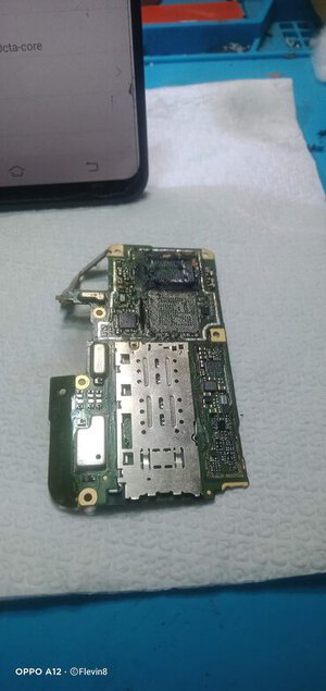

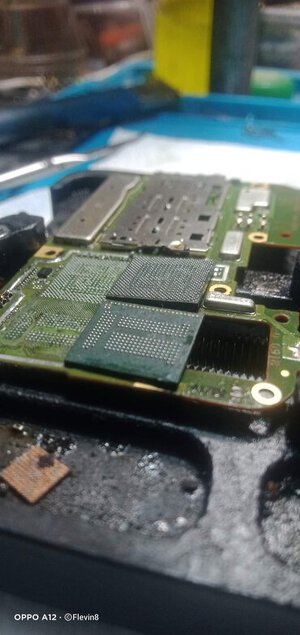

wala na info emmc or dead n emmc..
kaya transplant na solution..
from scrap.. :D :D
yan na po result,,,
