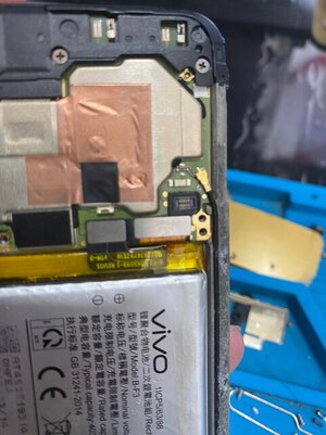

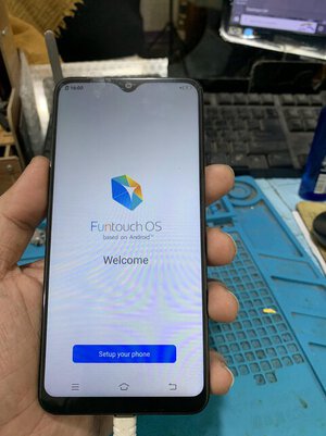

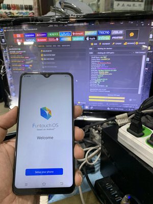

Lans1983 Registered Joined Oct 31, 2022 Messages 13 Reaction score 7 Points 1 Location novaliches quezon city Nov 6, 2022 #1 vivo y91 password remove by unlocktool adz lng mga idol baklast unit via test point open unlocktool qualcomm snapdragon find y91 click factory reset Attachments 2022_11_06_18_42_IMG_0634.JPG 50.3 KB · Views: 248 2022_11_06_18_42_IMG_0635.JPG 64.1 KB · Views: 251 test point.jpg 58.1 KB · Views: 251
BAGGER Registered Joined Oct 18, 2021 Messages 620 Reaction score 561 Points 421 Location Cebu May 19, 2023 #2 boss mawalang galang san po dyan pwdi tusukin boss sa my BAT poba banda boss
