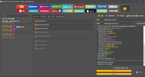

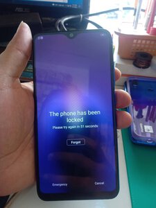

Vivo y91 Password
1st open unlock tool
2nd Select Vivo
search y91

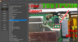

3rd Testpoint
click Factory Reset

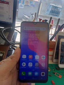

Done..
