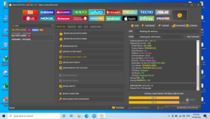

Vivo Y91i (1820) Password & FRP Done UNLOCKTOOL
ito pa sya nung naka pattern pa ang unit
1. Open UNLOCKTOOL
2. Select VIVO, Then Select Y91C (1820)
3.Then Click [BROM] FACTORY RESET + FRP
4. Turn OFF The Phone, Then salpak ang USB no need na bootkey
5. Pag nag Connect na hintayin Until Done..

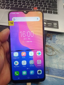

ito na finish product..
