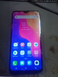

good day ka ant share ko lang vivo y91i/ vivo 1820 removed password using mrt crack 3.19 tested by me!!.. sa wlang unlocktool tulad ko!
mga procedure sundan nyu nlng sa pic

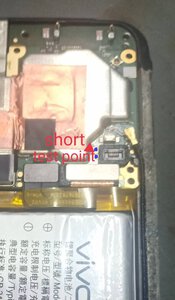

1 short test point battery unplug dapat ma detect qualcomm driver same procedure sa vivo y11

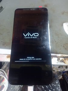

3 keep patient medyo matagal lng mag reboot

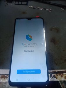

4 manual lng sa frp alams nyu na
5 done..
