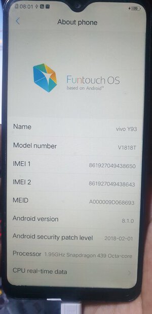

Share ko lang itong vivo y93 V1818T Password Problem done by UnlockTool

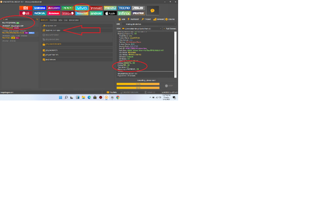

1.Open UnlockTool
2,Select Brand: VIVO
3.Search: Vivo Y93 [V1818A] edl

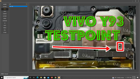

4.Testpoint CP and Connect usb cable
5,Click: [EDL] FACTORY RESET and wait until it Done
TP.

PASENSIYA NA PO HINDI KO NA NAKUN NA NAKA PASSWORD
