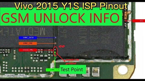

unit vivo y1s
problem password
procedure = https://www.youtube.com/watch?v=PRc_aH9g09Q&t=39s

tested by me
hindi ko na picturan boss
first baklas ko ang unit tapos TP na yong clk to ground lodi

tested to sakin boss wag lang kabahan hindi ko rin na ss sakin pa close na kasi ako pero tested ito
