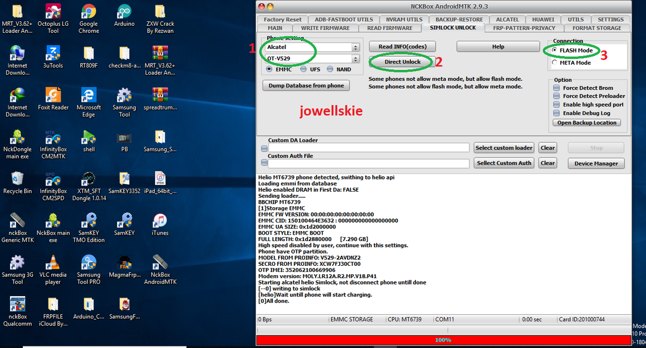

PROCEDURE
link NCKBOX v2.9.3
1. Open NCK AndroidMTK
2. Select Unlocking Tab
3. Select Alcatel, Model: OT V529
4. Click Direct Unlock
5. insert microusb to the unit
6.wait until done..
