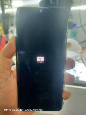

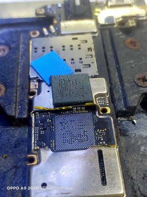

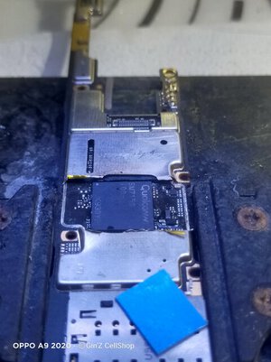

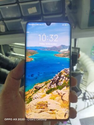

-=GinZ=- Expired Account Joined Oct 30, 2022 Messages 190 Reaction score 593 Points 241 Location Ginz Cellshop, Castilla Sta. Barbara Iloilo City Dec 3, 2022 #1 Another Xiaomi Mi Note 10 Lite Display issue (garbage/scrambled display) fixed again via TESTED CPU REWORK Tanggal CPU - Heat 380° Air 60 Balik CPU - Heat 380° Air 35 Reballing paste mid temp 158° Done po sana mka tulong

FredzyNoy Premium Account Joined Apr 9, 2018 Messages 1,801 Reaction score 3,452 Points 741 Location 845 m.de la fuente st.sampaloc,manila Dec 9, 2022 #3 sa pagreball master anu temp ng hotair
